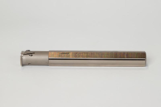

Grooving Tools – Guidelines:
____________________________
Haas Grooving Tools can be used for grooving, parting-off, facing, as well as general turning operations. These versatile tools use allow the machinist to use a single tool for many applications, reducing the number of tools in the turret, and the number of necessary tool changes.
The carbide inserts are reversible, with two cutting edges for more economical machining. The flat geometry of the cutting edge and wiper function of the insert ensure excellent surface finishes, even at high feedrates.
Advantages:
  • Suitable for grooving, facing, face grooving, parting-off, and general turning
  • Strong clamping system ensures stable and accurate machining
  • A single tool can be used for multiple applications
  • Replaceable carbide inserts for economical machining
  • Available for external (OD) and internal (ID) applications
Selecting the Correct Grooving Tool/Insert:
Haas Grooving Tools are defined by the following requirements:
  • Lathe turret/tooling size
  • External (OD) or internal (ID) machining
  • Required cutting depth (T-max)
  • Insert cutting width
  • Insert style
Insert Features:
  • All inserts are made from high-quality cemented carbide and are TiAlN (Titanium Aluminum Nitride) PVD coated for high wear resistance and lower friction, as well as higher cutting feeds and speeds
  • HU30 and HUU20P grades for Steel, Stainless, and Cast Iron with the option to use on Aluminum and Non-Ferrous Alloys
The chart below highlights the various styles of Haas Grooving Inserts. Use the appropriate filters to select the parameters that best correspond to your specific grooving application.

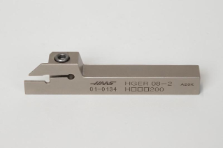

HGER08-2, 1/2" Square Steel Shank External (OD) Grooving Tool, Right-Hand, Insert Size 2
Part #: 01-0134
RETAIL PRICE: $80.95 $undefined
$56.97

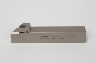

HGER16-3, 1" Square Steel Shank External (OD) Grooving Tool, Right-Hand, Insert Size 3
Part #: 01-0138
RETAIL PRICE: $88.95 $undefined
$62.97

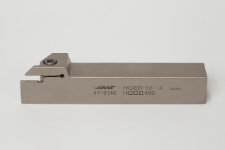

HGER16-4, 1" Square Steel Shank External (OD) Grooving Tool, Right-Hand, Insert Size 4
Part #: 01-0140
RETAIL PRICE: $87.95 $undefined
$61.97

HGIR12-10-2, 5/8" Ø Steel Shank Internal (ID) Grooving Bar, Right-Hand, Insert Size 2, Through-Tool Coolant
Part #: 01-0142
RETAIL PRICE: $94.95 $undefined
$66.97

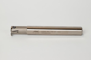

HGIR20-16-2, 1" Ø Steel Shank Internal (ID) Grooving Bar, Right-Hand, Insert Size 2, Through-Tool Coolant
Part #: 01-0144
RETAIL PRICE: $115.95 $undefined
$81.97

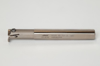

HGIR16-12-3, 3/4" Ø Steel Shank Internal (ID) Grooving Bar, Right-Hand, Insert Size 3, Through-Tool Coolant
Part #: 01-0145
RETAIL PRICE: $97.95 $undefined
$68.97

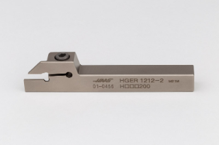

HGER1212-2, 12mm Square Steel Shank External (OD) Grooving Tool, Right-Hand, Insert Size 2
Part #: 01-0456
RETAIL PRICE: $110.95 $1,498.95 $446.95 $59.95 $269.95 $629.95 $undefined
$77.97
1049.97
312.97
41.97
188.97
440.97
