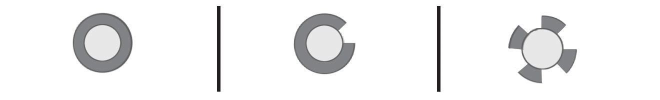

SMOOTH
SURFACE
MEDIUM TO
ROUGH SURFACE
ROUGH
SURFACE
Smooth Cut
Pre-Turned
Lightly
Interrupted
Heavily
Interrupted
