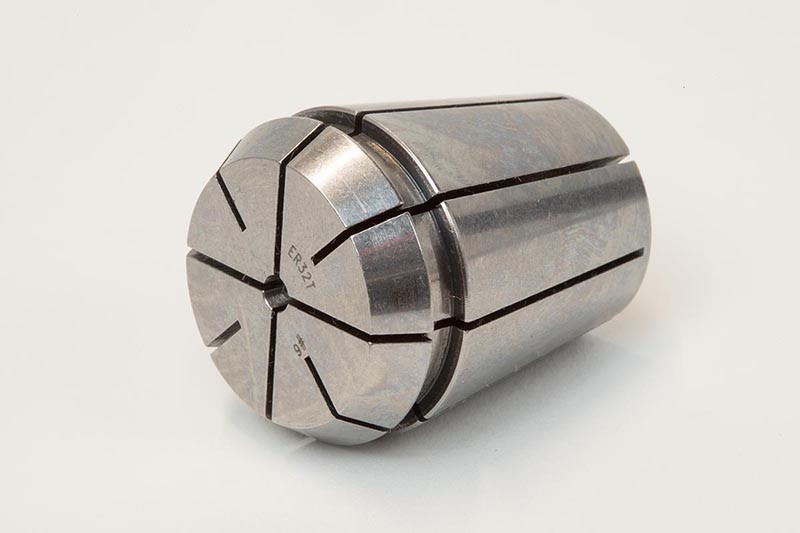

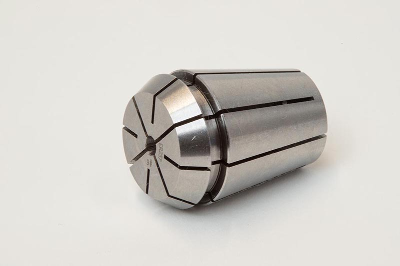

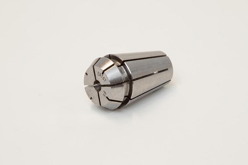

ER16 #4 - #6 Tap Collet, 0.141" Bore Diameter x 0.11" Square
Part #: 04-0103
RETAIL PRICE: $23.95
$20.97
ER25 #4 - #6 Tap Collet, 0.141" Bore Diameter x 0.11" Square
Part #: 04-0111
$16.97
ER32 #4 - #6 Tap Collet, 0.141" Bore Diameter x 0.11" Square
Part #: 04-0124
RETAIL PRICE: $26.95
$18.97
