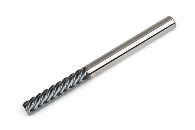

1/4" Dia. Carbide End Mill, 6 Flute, Hyb. AlCrN Coated, 1/4" Smooth Shank x 1-1/8" LOC, 0.015" Radius, HEPM
Part #: 03-2138
EM6FL1/4(R.015)x1/4x1-1/8x3" CS AlCrN
Customer Rating:
Price: 26.95 ( / unit)
20.97
This HEPM 6-flute carbide end mill has a 0.25 in \ 1/4" cutting diameter, with a 1/4" smooth shank, 1-1/8" length of cut (LOC), 0.015" radius, and a 3" overall length. It is hybrid AlCrN coated, and made to cut steel and stainless steel, but is capable of cutting some grades of cast iron and high-temp. alloys. This end mill is designed to center-cut, and the unique, variable pitch configuration helps to reduce unwanted harmonics and vibrations.

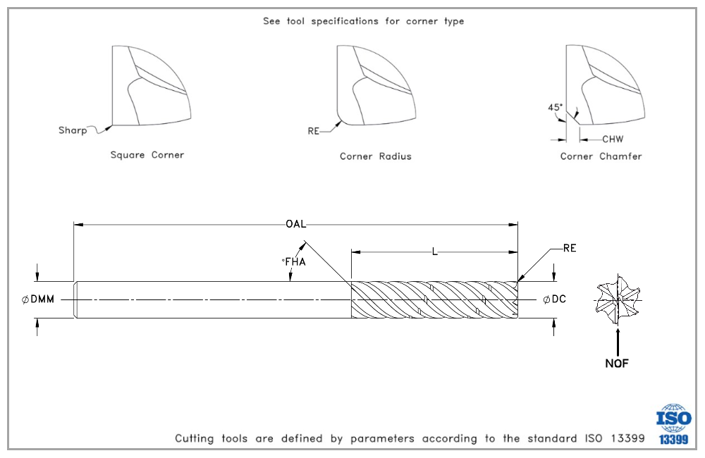

ISO Material Chart
[ØDC] Cutting Diameter 0.25 in \ 1/4"
Haas Milling Series HEPM
Primary Workpiece Material M - Stainless Steel, P - Steel
Secondary Workpiece Material S - High Temp Alloys, K - Cast Iron
Material Carbide
Coating Hybrid AlCrN
Corner Type Radius
Shank Type Smooth
[ØDMM] Shank Diameter 0.25 in
[LOC] Length Of Cut 1.125 in
[OAL] Overall Length 3.0 in
[NOF] Number of Flutes 6
[CHW\RE] Chamfer \ Radius Size 0.015 in
[FHA°] Helix Angle 45
Cutting Direction Right
Center Cutting Yes
Variable Pitch Yes
Through Spindle Coolant No
