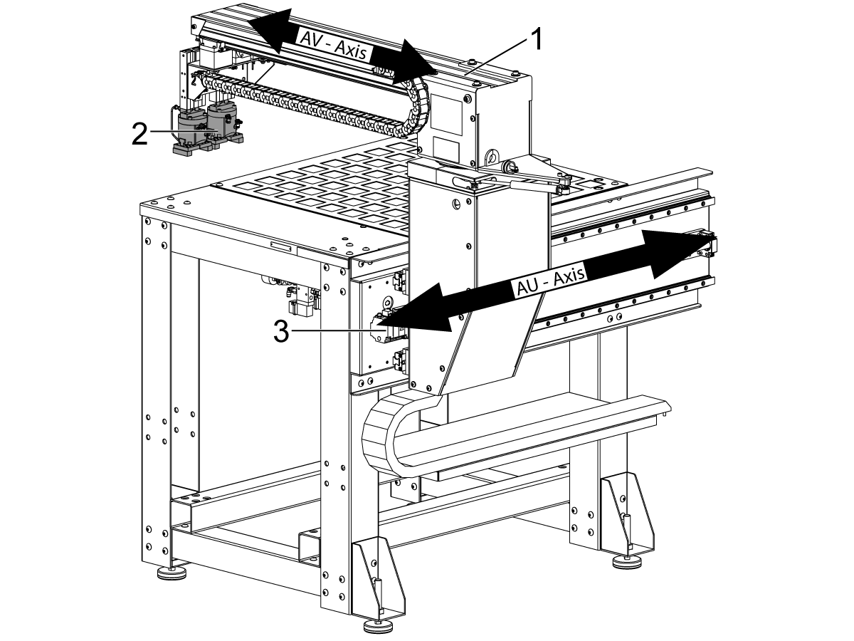

1.2 Axis Definitions
Compact APL - Axis Definitions
  1. AV-Axis: the grippers are moved across this axis.
  2. Grippers.
  3. AU-Axis: the gripper arm is moved across the table and into the machine.
