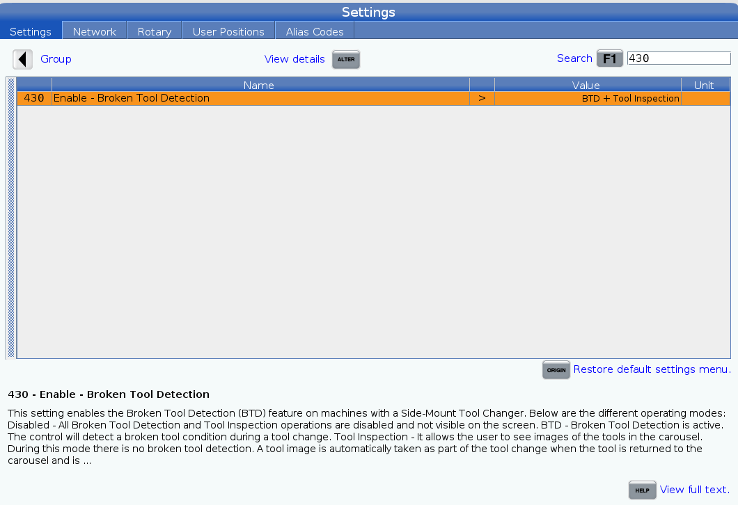

IMPORTANT: With the machine in service mode, make sure that Setting 430 is set to ON.

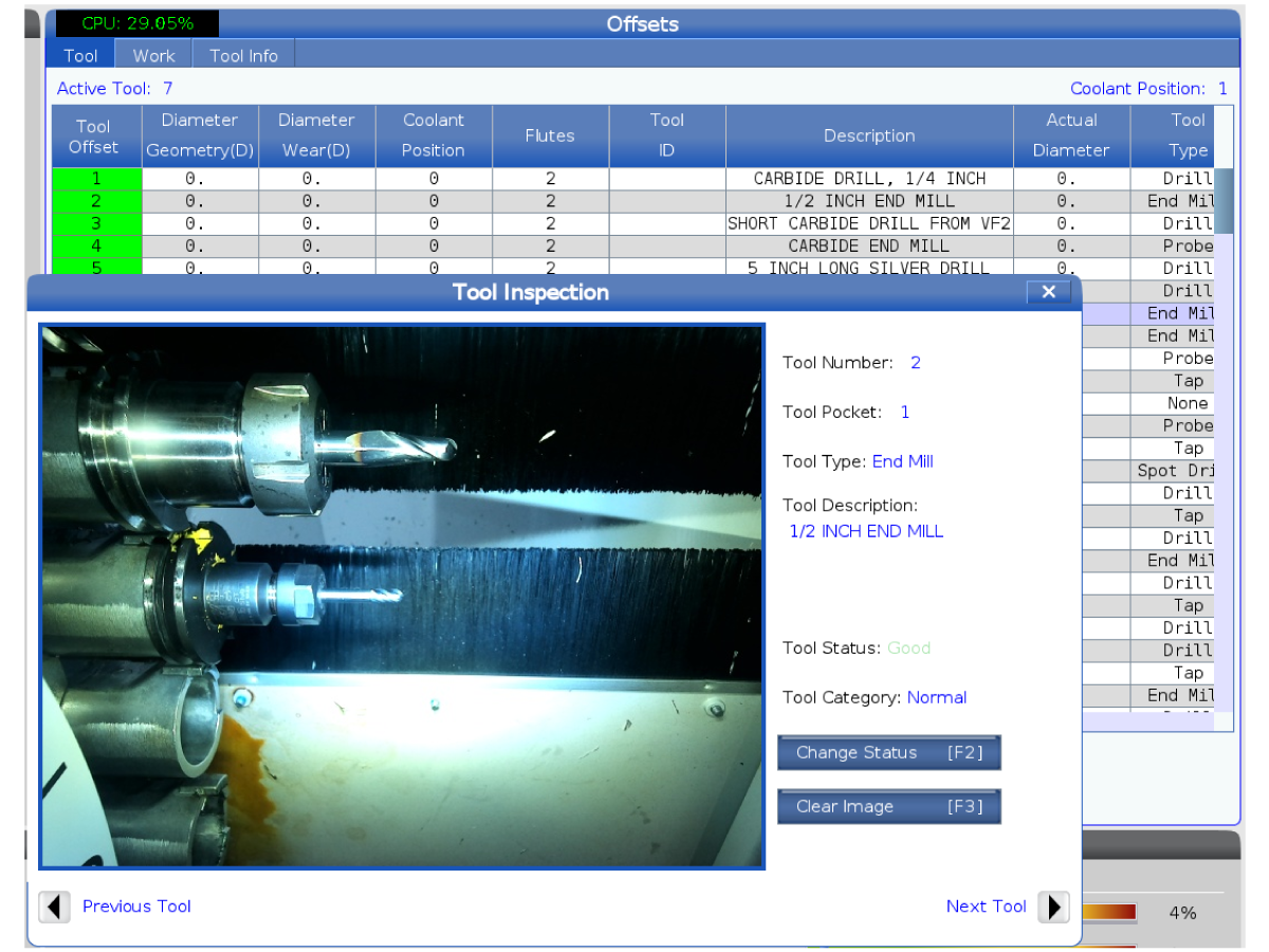

Software 100.25.001.1100 implements tool inspection which takes pictures of the tools once they return to the carousel from the spindle.
 NOTE: This feature is only compatiable on machines with a 19 inch pendant.
This feature uses the BTD system to activate.

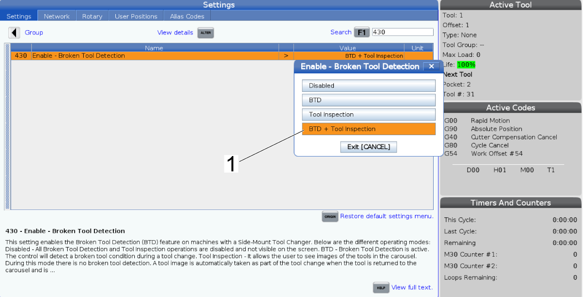

To activate Broken Tool Detection and Tool inspection, press [SETTING] then search "430".
Press the right arrow key to toggle BTD + Tool Inspection [1].
Additional information for this setting can be found under the Setting 430 - Enable - Broken Tool Detection page.

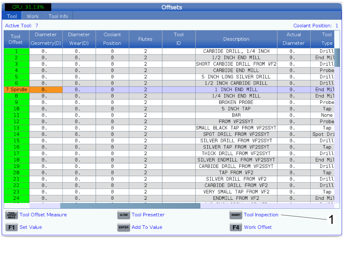

The Tool Table page [1] can be found by pressing [CURRENT COMMANDS] then navigating to Tools > Tool Table.
Press [INSERT] to display the image of the selected tool.
Alternatively, select [F2] to capture an image of the tool.
Pressing [F3] will capture images of all tools, including the tool loaded into the spindle, if applicable.
To display the image of a tool, press [OFFSET] and highlight the desired tool, then press [INSERT] to inspect the tool [1].
To change the status of a tool, press [F2]. This will allow the user to manually change the tool status.
 NOTE: The tool must have the BTD box checked under the Tool Table page.
The tool inspection page may only hold one image at a time. To clear the image, press [F3].

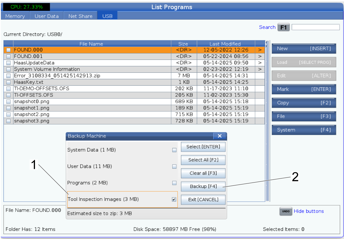

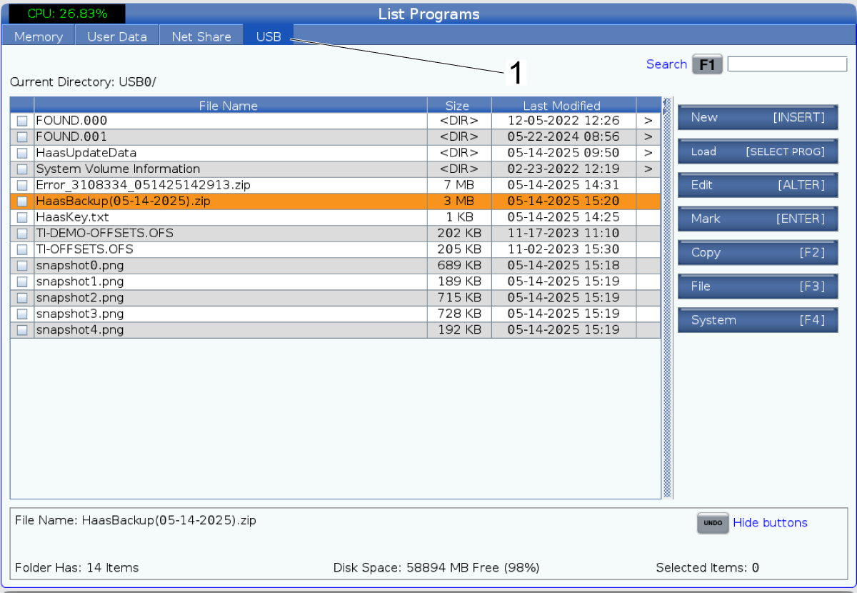

To save an image of a tool to a USB, press [LIST PROGRAM] and navigate to the USB tab [1].
 NOTE: You must have a USB to save captured images.
7
Press [F4] > Backup Machine and deselect all boxes except Tool Inspection Images [1] by pressing [ENTER].
Press Backup [F4] again to save files to the USB [2].

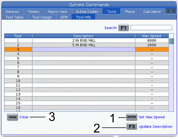

Tool Info Display
The Tool Info display tab allows user to specify maximum RPM for a tool. You can also specify a tool description in the same table.
To get to the Tool Info display press [CURRENT COMMANDS] then go to Tools and then Tool Info tab.
  1. To set the max speed for a tool highlight the tool row and type in the desired max speed and press [ENTER] .
  2. To set the tool description highlight the tool row and type in the description and press [F3] .
  3. To clear the tool max speed or description press [ORIGIN] .

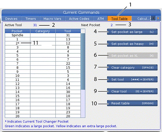

 NOTE: If your machine has an umbrella-style tool changer, you will not use the tool pocket table.
Tool Table Display:
  • To access the Tool Pocket Table, press [CURRENT COMMANDS] and choose the Tool Table tab [1].
  • Active Tool [2] - Tells you the tool number that is installed in the spindle
  • Active Pocket [3] - Shows you the next pocket number.
  • Set pocket as large [L] [4] - Use this flag when a large tool has a diameter of greater than 3" for 40-tape machines and greater than 4" for 50-taper machines. Scroll to the pocket of interest and press [L] to set the flag.
     CAUTION: You cannot place a large tool in the tool changer if one or both of the surrounding pockets already contain tools. Doing so causes the tool changer to crash. Large tools must have the surrounding pockets empty. However, large tools can share adjoining empty pockets.
  • Set pocket as heavy [H] [5] - Use this flag when a Heavy, Small Diameter 40-taper tool (4 lb or heavier) or a 50-taper tool (12 lb or heavier) is loaded into the spindle. Scroll to the pocket of interest and press [H] to set the flag.
  • Set pocket as XL [X] [6] - Use this flag when two adjacent pockets are each side of the tool are needed. Scroll to the pocket of interest and press [X] to set the flag.
     NOTE: This option only appears if your machine is a 50-taper.
  • Clear category [SPACE] [7] - Highlight the desired tool and press [SPACE] to clear the flag.
  • Set tool [###] + [ENTER] [8] - Highlight the desired pocket and type in the tool number along with [ENTER] to set the desired tool number.
     NOTE: You cannot assign a tool number to more than one pocket. If you enter a tool number that is already defined in the tool pocket table, you see an Invalid tool error.
  • Clear tool [0] + [ENTER] [9] - Highlight the desired pocket and press [0] along with [ENTER] to clear out the tool number.
  • Reset table [Origin] [11] - Press [ORIGIN] with the cursor in the center column to use the [ORIGIN] menu. This menu lets you:
    • Sequence All Pockets - Makes all of the tool numbers sequential based on their pocket location, starting with 1.
    • Zero All Pockets - Removes all of the tool numbers from all of the pocket numbers.
    • Clear Category Flags - Removes the category designations from all of the tools.

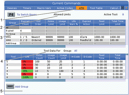

To use ATM, press [CURRENT COMMANDS] , and then select ATM in the tabbed menu. The ATM window has two sections: Allowed Limits and Tool Data.
Advanced Tool Management Window:
  • Active window label [1]
  • Allowed limits window [2]
  • Tool group window [3]
  • Tool data window [4]
  • Help text [5]
Allowed Limits
This table gives data about all of the current tool groups, including default groups and user-specified groups. ALL is a default group that lists all of the tools in the system. EXP is a default group that lists all of the tools that are expired. The last row in the table shows all of the tools that are not assigned to tool groups. Use the cursor arrow keys or [END] to move the cursor to the row and see these tools.
For each tool group in the ALLOWED LIMITS table, you define limits that determine when a tool expires. The limits apply to all tools assigned to this group. These limits affect every tool in the group.
The columns in the ALLOWED LIMITS table are:
  • GROUP - Displays the tool group’s ID number. this is the number you use to specify the tool group in a program.
  • EXP # - Tells you how many tools in the group are expired. If you highlight the ALL row, you see a list of all of the expired tools in all groups.
  • ORDER - Specifies the tool to use first. If you select ORDERED, ATM uses the tools in tool number order. You can also have ATM automatically use the NEWEST or OLDEST tool in the group.
  • USAGE - The maximum number of times the control can use a tool before it expires.
  • HOLES - The maximum number of holes a tool is allowed to drill before it expires.
  • WARN - The minimum value for tool life remaining in the group before the control gives a warning message.
  • LOAD - The allowed load limit for tools in the group before the control does the ACTION that the next column specifies.
     WARNING: Load limit should not be used for applications where spindle speed and feed change rapidly. For example, tapping or constant surface speed.
  • ACTION - The automatic action when a tool reaches its maximum tool load percentage. Highlight the tool action box to change and press [ENTER] . Use the [UP] and [DOWN] cursor keys to select the automatic action from the pull down menu ( ALARM, FEEDHOLD, BEEP, AUTOFEED, NEXT TOOL).
  • FEED - The total amount of time, in minutes, that the tool can be in a feed.
  • TOTAL TIME - The total amount of time, in minutes, that the control can use a tool.

You can save to USB the variables associated with Advanced Tool Management (ATM).
To save the ATM information:
  1. Select the USB device in the Device Manager ([LIST PROGRAM] ).
  2. Type a filename on the input line.
  3. Press [F4] .
  4. Highlight SAVE ATM in the pop-up menu.
  5. Press [ENTER] .
Restore Advanced Tool Management Tables
You can restore from USB the variables associated with Advanced Tool Management (ATM).
To restore the ATM information:
  2. Press [F4] .
  3. Highlight LOAD ATM in the pop-up menu.
  4. Press [EMERGENCY STOP] .
  5. Press [ENTER] .
