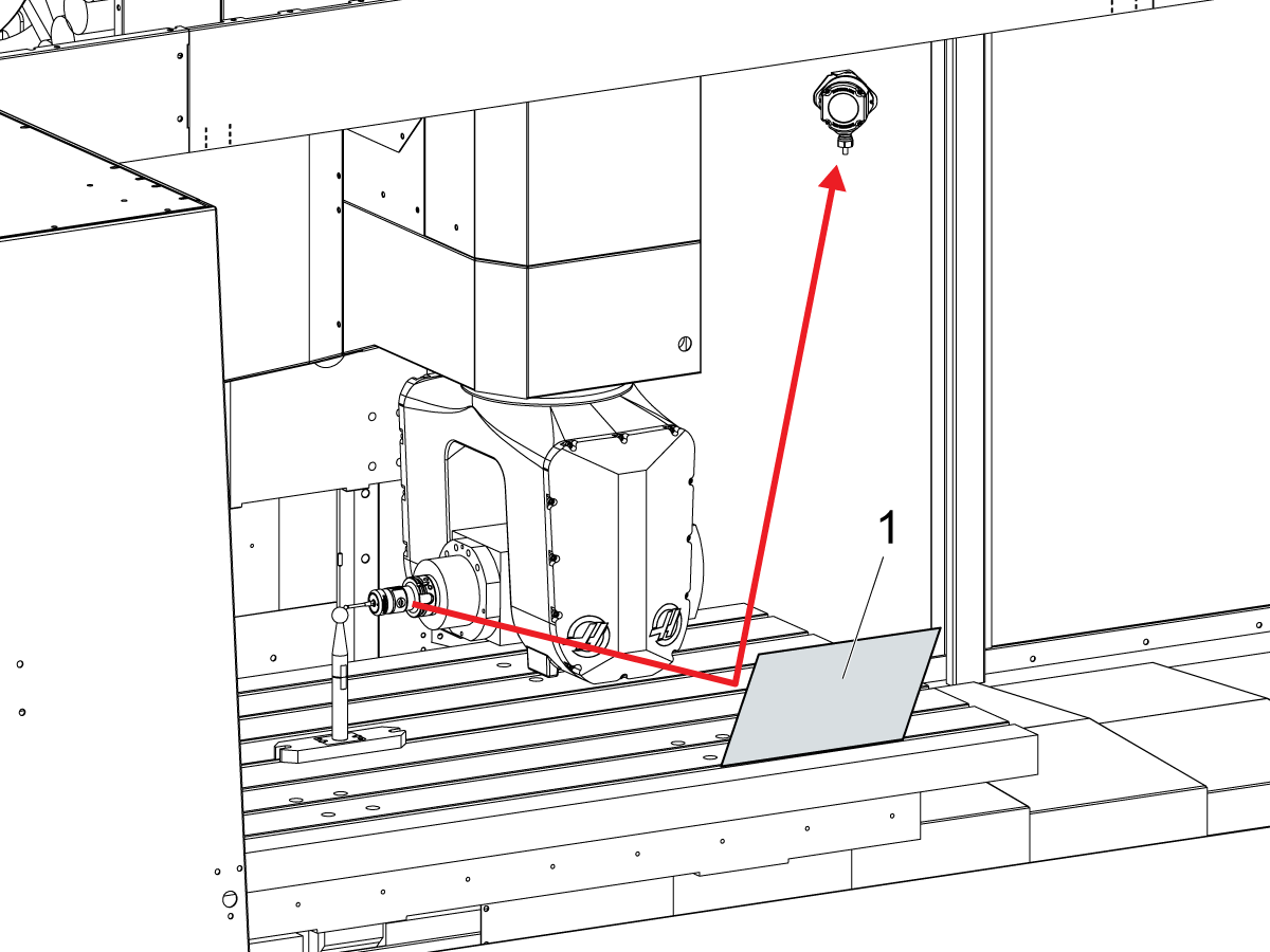

Interference
Corrective Action:
Turn the work lights off to begin troubleshooting. Make sure the work lights inside the machine are not aimed at the probe or the RMI-QE. Bright lights can interfere with the work probe. Make sure no bright lights are aimed at the machine.

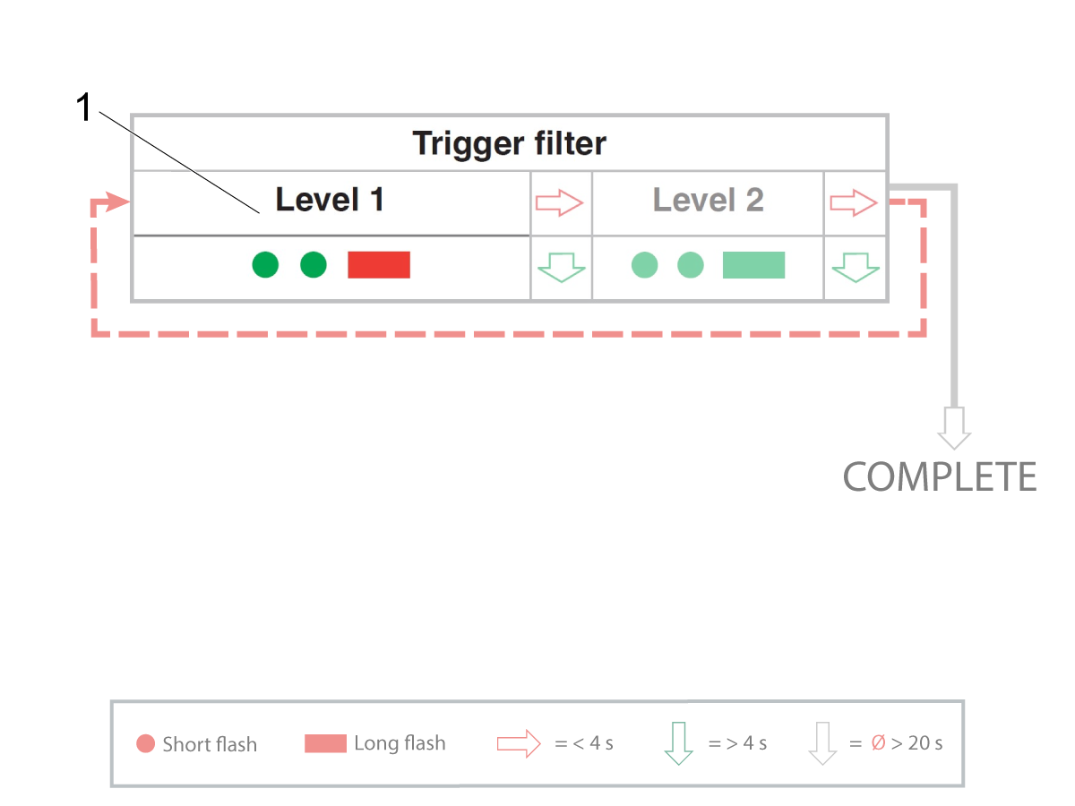

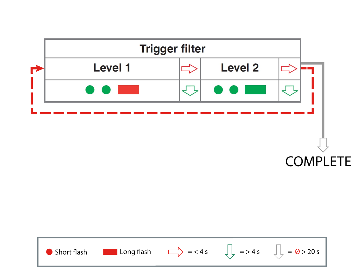

OMP 40-2 Work Probe Settings
Probe Settings Basics
The probe settings are in these (4) groups:
  1. Switch-Off Method
  2. Enhanced Trigger Filter
  3. Optical Transmission Method/Probe Identification
  4. Optical Power
The sequence that probe flashes tells you the current probe settings.
 Note: The LEDs flash in different colors and different lengths of time. The sequence that the LED flashes tells you the probe settings. The LEDs flashes a short or a long time. In the tables that follow, a small colored circle  shows that the LED flashes a short time. A rectangle  shows that the LED flashes a long time.
To see what the current probe settings are, do the following:
Remove the batteries from the probe for a minimum of 5 seconds.
Install the batteries.
Important: Do not touch the probe stylus after re-inserting batteries - this is how probe settings are changed. Only touch it later if necessary to change the settings.
After you replace the batteries, the probe LED flashes in a specific sequence.
Look at the probe LEDs. Record the sequence that the LED flashes.
Refer to Renishaw - Probe - OMP40-2 - Settings for the meaning of the sequence.
If you would like to change the probe settings, do the following:
Remove the batteries [1] from the probe for a minimum of 5 seconds.
Move and hold the stylus [2] while installing the batteries.
Hold the stylus until the probe completes the LED sequence [3] and flashes Red 5 times.
Release the stylus.
To change the probe settings you move the stylus in a specified order, refer to the tables below for the orders for different settings:
The Illustration shows these symbols: The symbols tells you this: This gives this result:
A red arrow that points to the right. Move and hold the stylus for less than (4) seconds. Selects the next option within a group.
A green arrow that points down. Move and hold the stylus for more than (4) seconds. Moves from one group to another.
A white arrow that points down. Do not touch the stylus for (20) seconds or more. Exits the set up.

Interference
Corrective Action:
Corrective Action:
Verify there are no objects obstructing the path of the radio frequencies between the RMI-QE, RMP40, and the RTS, as they can interfere with the probe communication.

Immediately after the LED sequence [2], deflect and hold the stylus [3], the probe will flash Red 8 times.
 Note: If the battery power is low, each red flash will be followed by a blue flash.
Keep the stylus deflected until the "Trigger filter" setting is displayed. Release the stylus.
Follow the below tables to select the values you want for the settings. Default factory settings are shown in the next set of tables:
