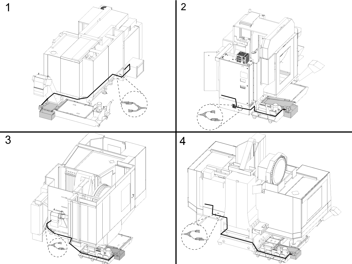

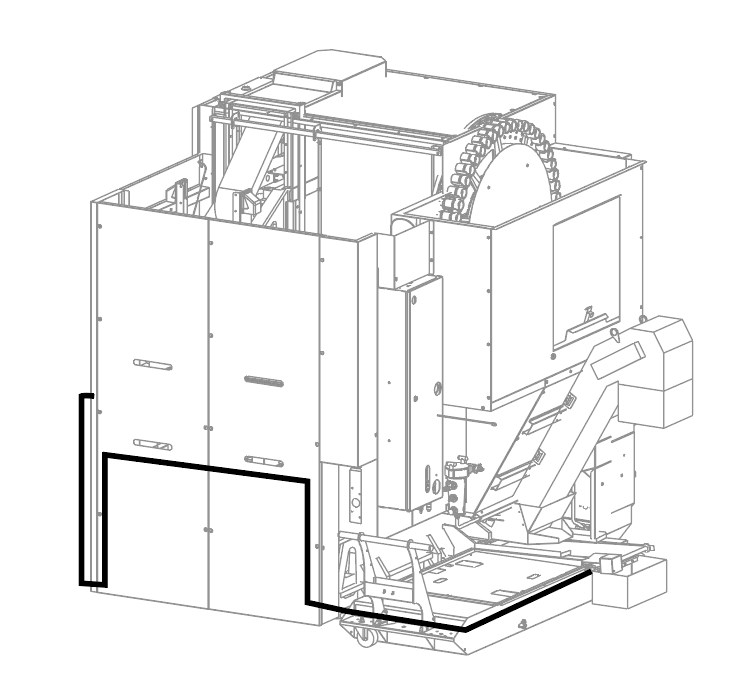

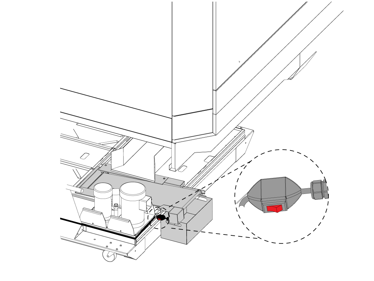

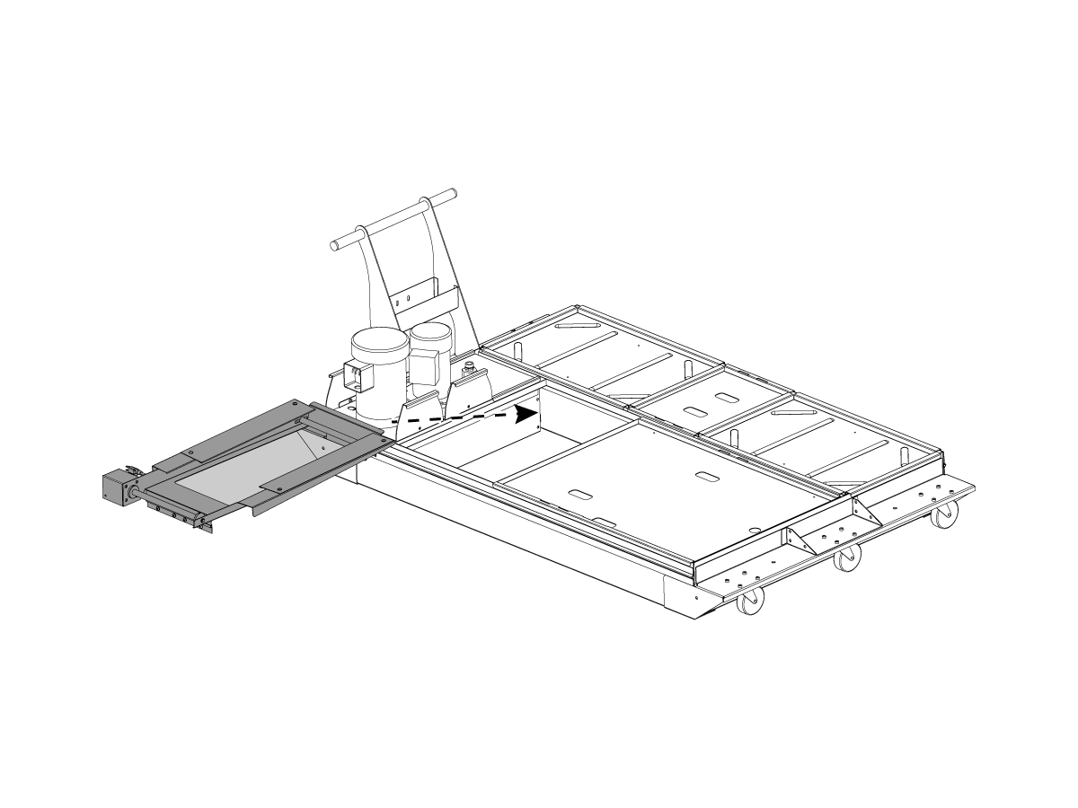

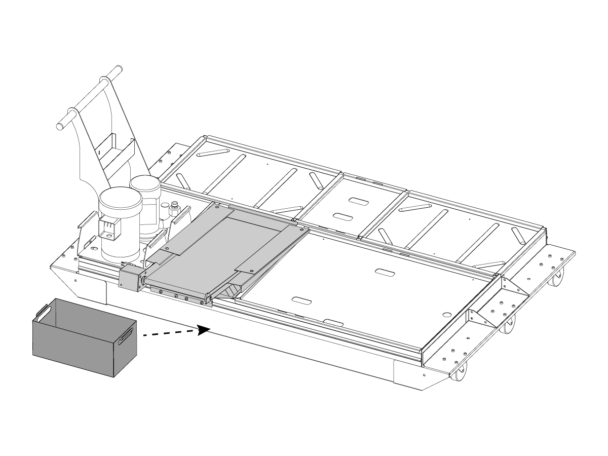

 Remove and replace the Chip Tray with the Mini Conveyor unit. Install the Mini Conveyor with the motor closest to operator.
With the coolant tank in place, position the Chip Bin under the conveyor discharge.

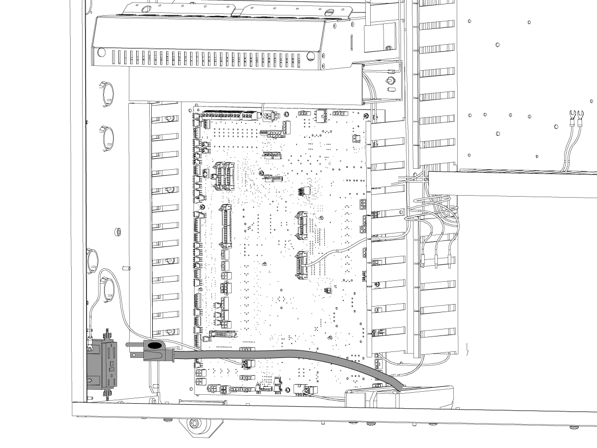

Connect the 115VA Splitter Plug to the GFCI outlet located inside the control cabinet. Route the Splitter down into the lower cabinet box and connect to the Mini Conveyor power plug. Some machine models may need to use Extension Cable provided with kit.
Images are for reference only:
  1. ST/DS
  2. DT/DM/UMC-350
  3. EC
  4. VMC
Use the Cable Ties and the Cable Tie Clamp as necessary to route the cable in the enclosure apron.
Note: If the machine has a Haas Oil Skimmer installed. Unplug the 25 FT Extension Cable from the GFCI and plug it into one of the open outlets of the 115VA Splitter.

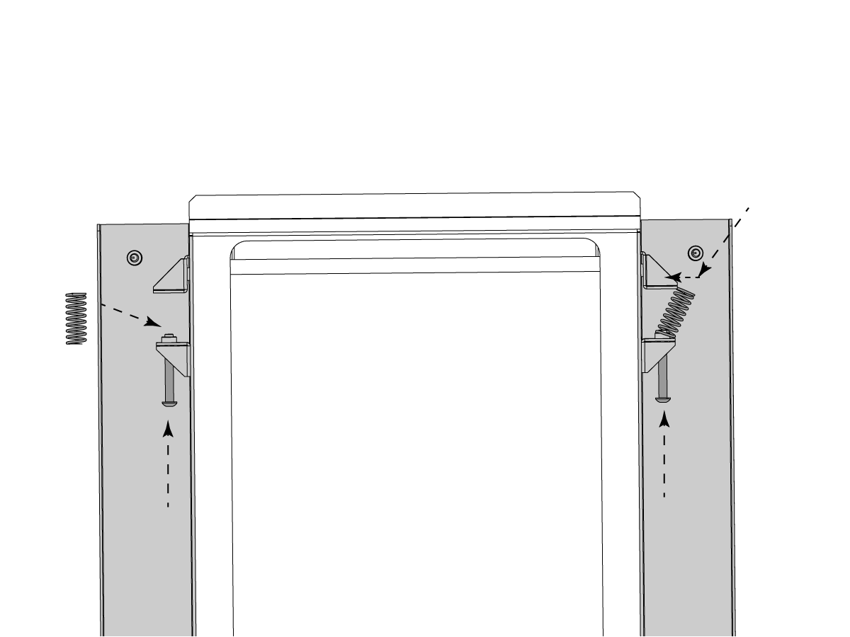

Note: Mini Conveyors with no Tensioning Spring, add Spring provided in the kit following Step 3 and Step 4. If Tension Spring is already in place, skip to step 5.

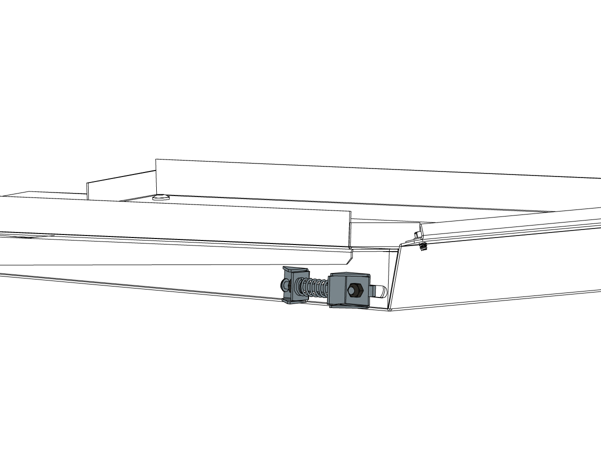

Holding the Jam Nut [3] in place, unscrew Tensioning Screw [1] and insert Tensioning Spring [2] between both tension brackets and screw Tensioning Screw [1] back in as you hold the Jam Nut [3] in place. The Tensioning Screw should be going through the Tensioning Spring as pictured in step 8.
Add Tensioning Spring to both left and right side of the Mini Conveyor and evenly tension the belt.

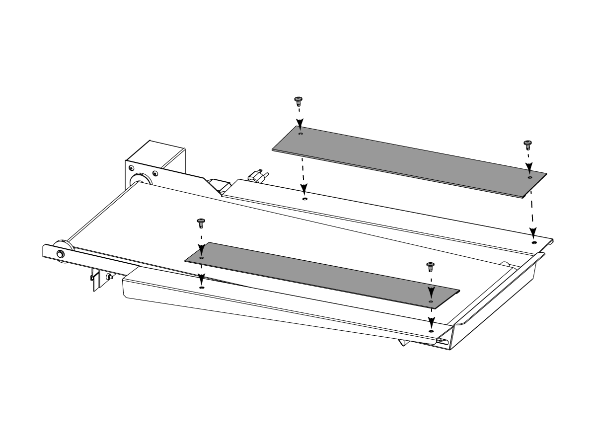

Replace wings with new wings provided in kit. Use ¼ x 20 bolts to install Left Wing [1] and Right Wing [2].

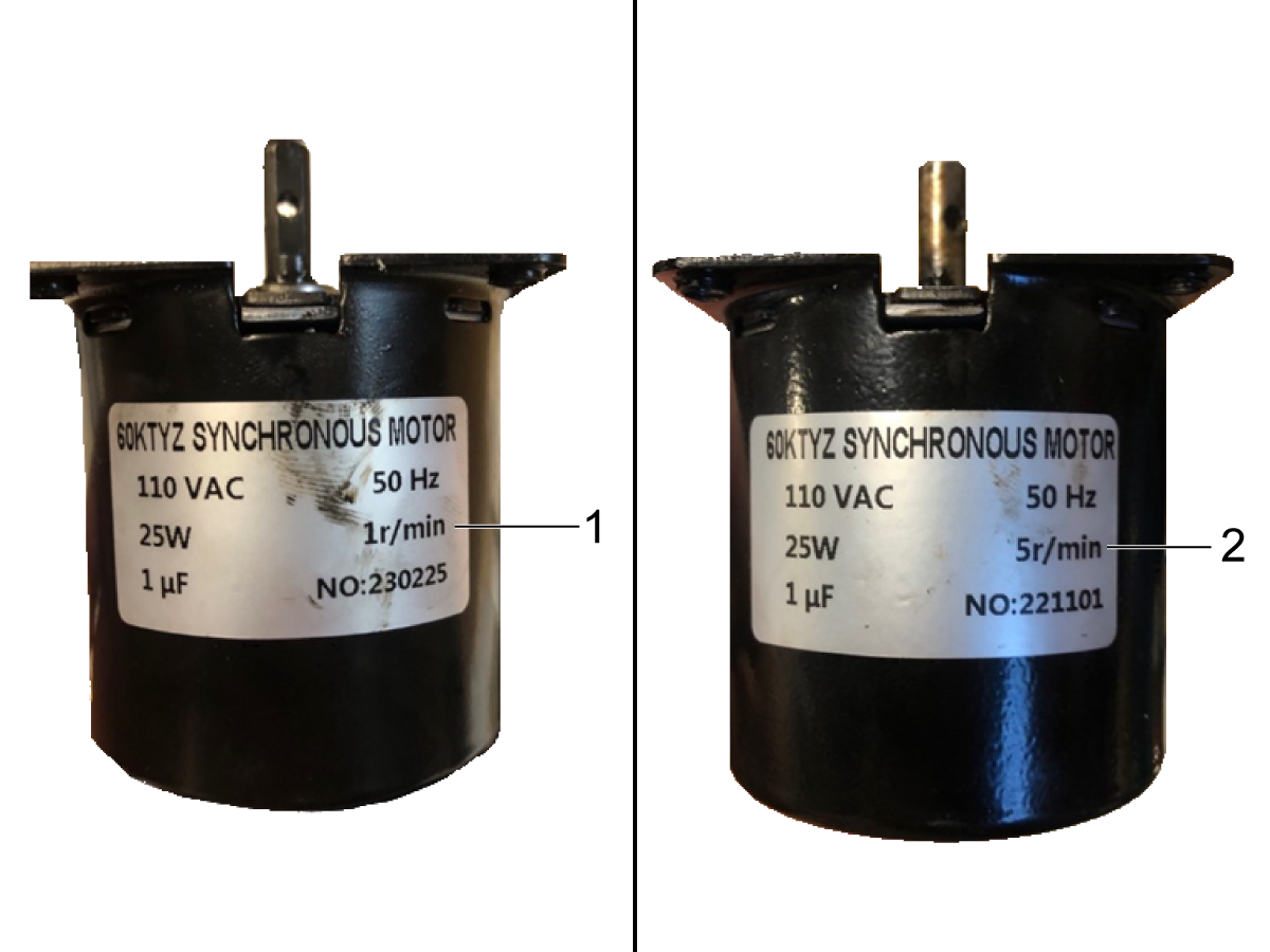

 Note: Check the motor name plate. It should be a 1 RPM motor [1]. If a 5 RPM motor [2] is installed, it will need to be retrofitted to a 1 RPM motor. Refer to the Mini Conveyor - Motor Replacement.

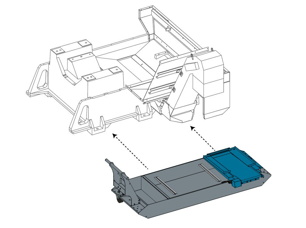

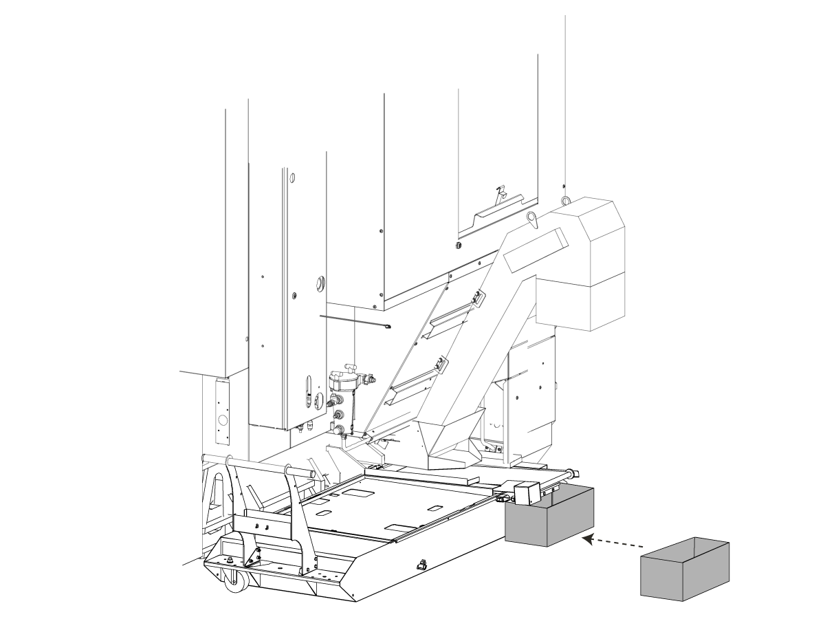

Place Mini Conveyor onto Coolant Tank.
9
Slide Coolant Tank in place.
10
With the Coolant Tank in place, position the Chip Bin under the conveyor discharge.

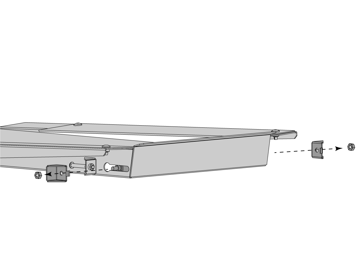

Back out the Tensioning Screws and Jamnuts on both sides to release tension from the belt.
Remove the tension springs from the tensions brackets.
Remove the 1/4-20 nut and tensioning brackets from both sides of the inner tensioning rod.

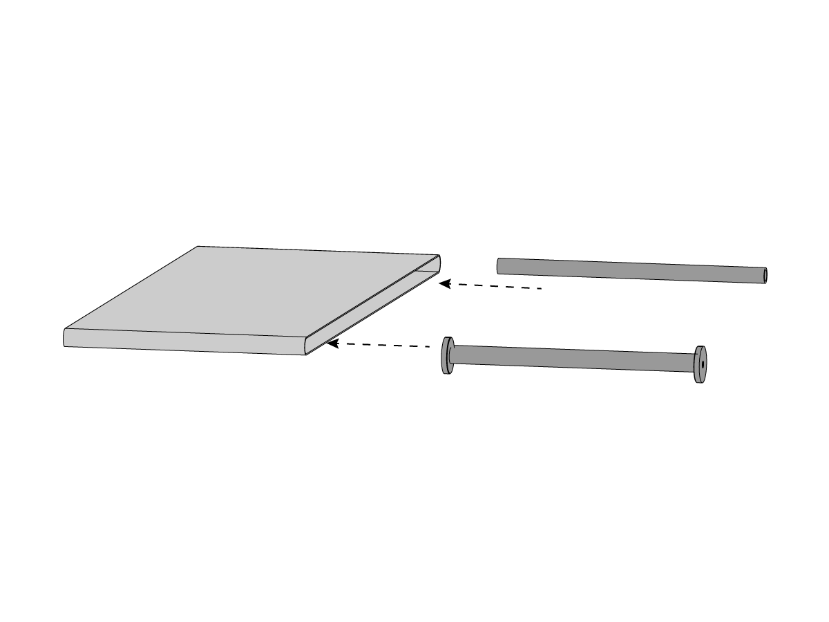

Install the drive rod assembly through the belt and onto the motor shaft.

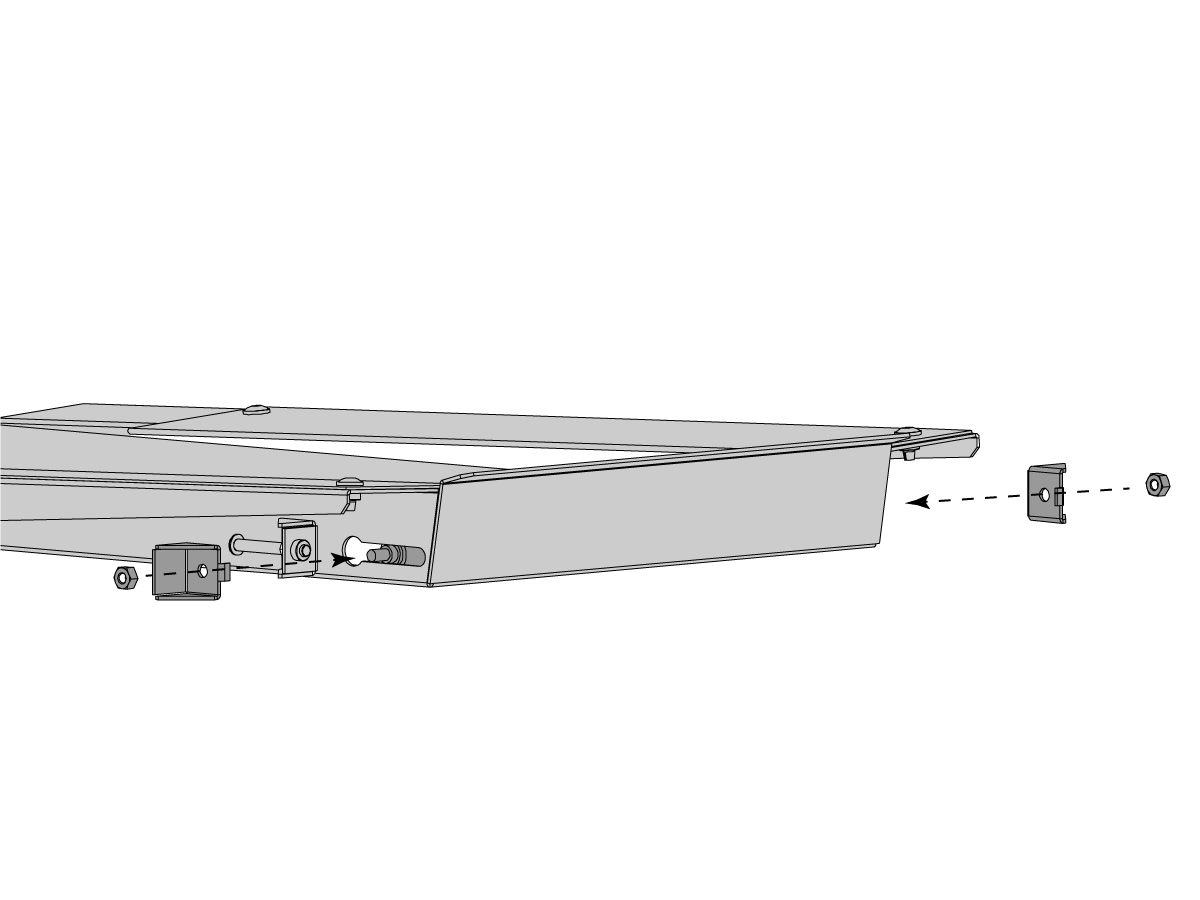

Insert the Rod Sleeve in the belt [1], install the Inner Rod through the opening in the chassis and into the Rod Sleeve.
Attach the Tensioning Brackets to both ends of the Slave Rod assembly.
Install the Tensioning Screws and Springs with Jamnuts to both sides and evenly tension the belt.

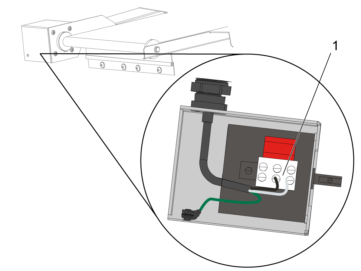

Remove the (4) screws [1] to remove the motor and the motor cover.
Disconnect Black and White [1] wires by loosening the screws to remove the motor and replace it with the motor provided in the kit.
Reconnect wires in the same order that the wires were connected.
