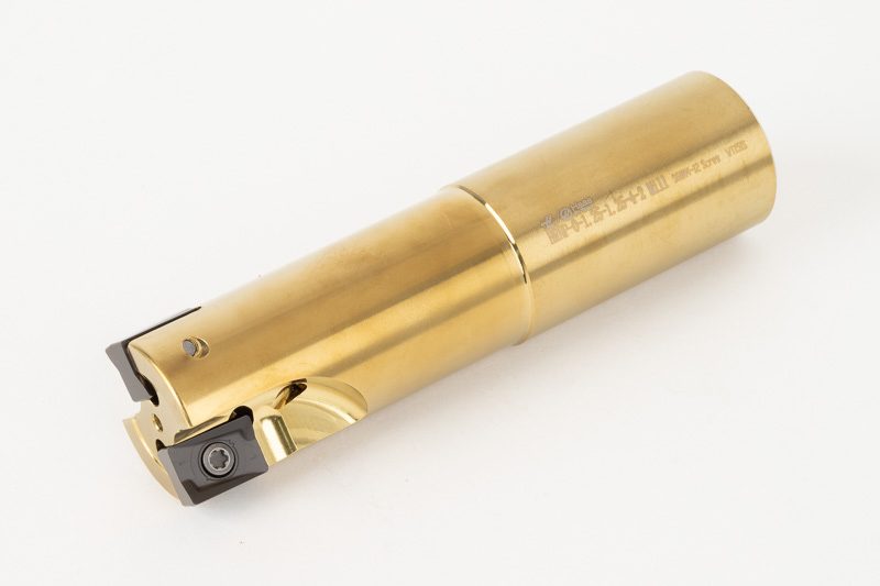

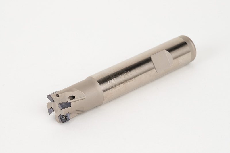

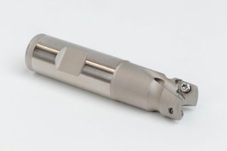

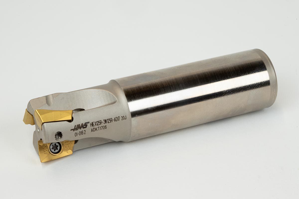

HIEX – Haas Indexable End Mill
Toolpath Type: Face Milling, Shoulder Milling, Slotting, Ramping, Helical Milling, Copy Milling
90° cutting edge | D.O.C. max. .649" (16.48mm)
• Inch sizes 1.0", 1.25", and 1.5"
• Metric sizes 25mm and 32mm
• Superior perpendicularity and minimized cutting loads
• Optimized for high-quality surface finishes
• High rake angle lowers cutting loads and minimizes burrs
• High-speed and high-feed capability
• 15% higher cutting speeds and feeds are possible
AVAILABLE HAAS GRADES
HU30
HP25
MKP30
APPLICABLE WORKPIECE MATERIALS
P
M
K

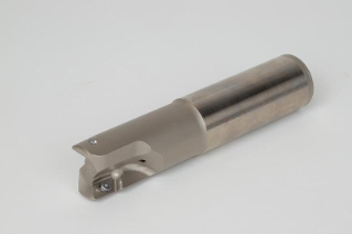

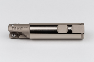

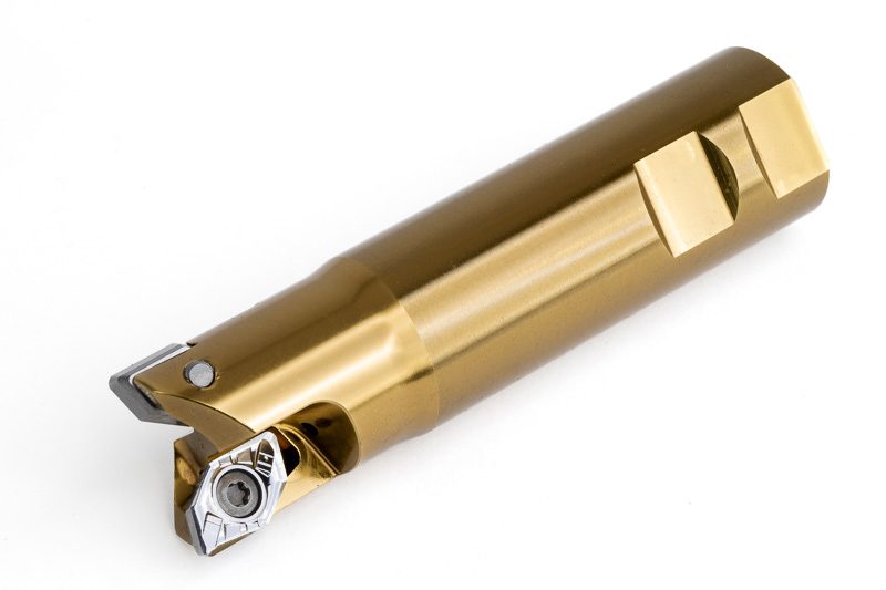

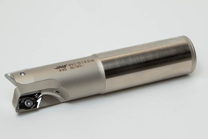

HPAL – Haas High Positive End Mill for Aluminum
90° cutting edge | D.O.C. max. .670" (17.00mm)
• Inch sizes 1.0" and 1.25"
• Buffed top surface ensures smoother chip evacuation, and reduces built-up edge
• Designed for high-speed machining of aluminum
• For milling square shoulders and curved surfaces
HN25
N

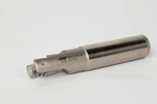

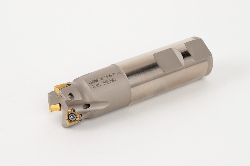

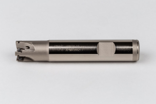

HIE – Haas Indexable End Mill
Toolpath Type: Face Milling, Shoulder Milling, Slotting, Ramping, Helical Milling, Plunging
90° cutting edge | D.O.C. max .217" (5.51mm)
• Inch sizes 0.75", 1.0", and 1.25"
• Metric sizes 20mm, 25mm, and 32mm
• 3-face clamping for stable operation in tough conditions
• Wide application range: steel, aluminum, cast iron
• Suitable for plunge milling
HU30
HU40
HP25
HN25A
P
M
K
N

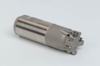

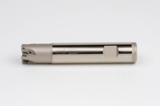

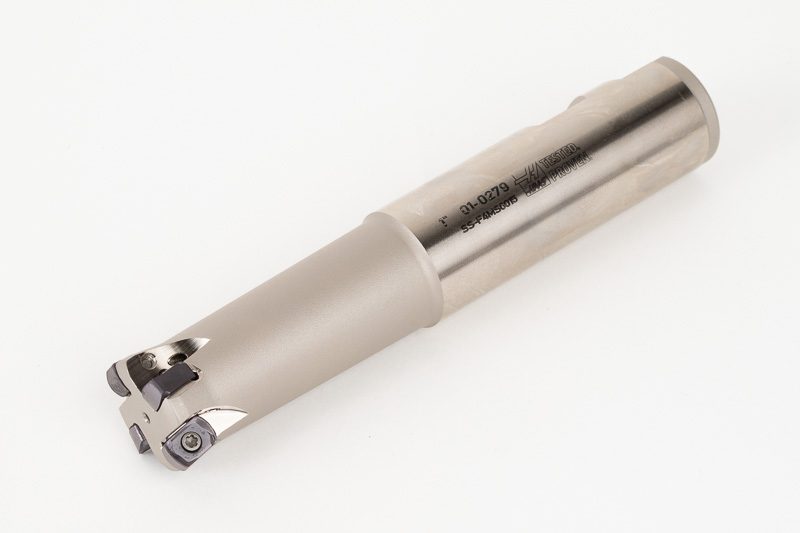

HEHF – Haas End Mill High Feed
Toolpath Type: High-Feed Milling, Face Milling, Ramping, Helical Milling, Copy Milling, Plunging
Curved edge | D.O.C. max 0.035" (0.89mm)
• Inch sizes 0.625", 0.75" , 1.00", and 1.25"
• Metric sizes 16mm, 20mm, 25mm, and 32mm
• Low entering angle for high feedrates
• High cost-efficiency, with 4-corner inserts
• Positive rake angle for lower cutting forces
• Wide flank face for rigidity and strong clamping
• Safely boost productivity with high feedrates
HU30A
P
M
K
H

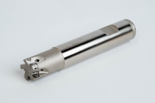

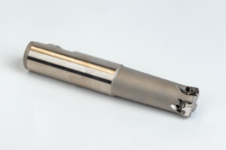

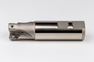

HMIEM – Haas Mini Indexable End Mill
90° cutting edge | D.O.C. max .220" (5.59mm)
• Inch sizes 0.50", 0.625", and .75"
• Metric sizes 12mm, 16mm, and 20mm
HU30
HN25A
P
M
K
N

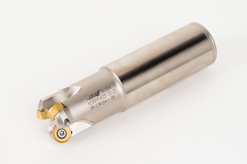

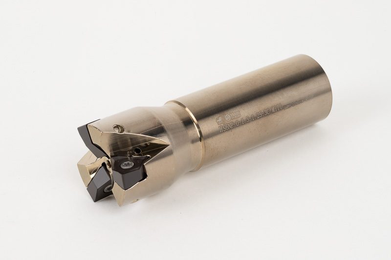

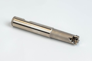

HRPP – Haas Round Positive Positive
Round edge | D.O.C. max. .236" (5.99mm)
• Metric sizes 25mm, 32mm, and 40mm
• High-speed and high-feed capability improve productivity
HU30
HU40
HP25
HN25A
HH10
P
M
K
N
