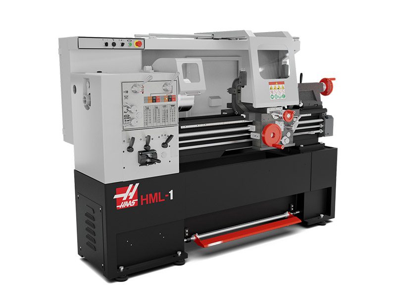

Haas Manual Lathe with 14" x 39" max capacity
The Haas HML-1 is a traditional-style manual engine lathe with a 14" x 39" (360 x 1000 mm) max capacity and 9" (229 mm) manual chuck.
  • D1-6 nose with MT6 internal taper
  • 9" (229 mm) manual 3-jaw chuck
  • 1800-rpm spindle
  • Digital Readout (DRO)
  • Manual tailstock with MT4 quill
  • 4-way tool post
  • Steady rest
  • Coolant system
  • Includes tool kit and box

STANDARD CONFIGURATION
SPINDLE
1800-rpm Spindle, D1-6 w/MT6 Taper
9" (229 mm) Manual 3-Jaw Chuck
CHIP & COOLANT MANAGEMENT
Coolant System with Splash Guard
CONTROL
2-Axis Digital Readout
PRODUCT FEATURES
Full-Length Splash Guard
Chuck Safety Guard with Limit Switch
Lead Screw Cover
Work Light
TOOLING & FIXTURING
4-Way Tool Post
Steady Rest
Tailstock w/MT4 Quill

Capacity Inch Metric
Height of centers 7.08" 180 mm
Swing over bed 14.17" 360 mm
Swing in gap 20.98" 533 mm
Swing over cross slide 8.27" 210 mm
Distance between centers 40" 1000 mm
Width of bed 10.236" 260 mm
Headstock and Main Spindle Inch Metric
Spindle nose, internal taper D1-6, MT6 D1-6, MT6
Spindle bore 2.066"
52.5
Chuck, 3-Jaw 9"  229 mm
Spindle speed
Gear steps / Range Std. : 8 steps / 70 ~ 1800 R.P.M.
  Opt. : 16 steps / 8P 40 ~ 1000 R.P.M.
Carriage Inch Metric
Length on bed / Width of carriage 20.19" / 16.22" 513 / 412 mm
Cross slide travel 8.6" 220 mm
Top slide travel 4.92" 125 mm
Threads and Feeds Inch Metric
Whitworth threads: Kinds / Range 45 Kinds / 2 ~ 72 T.P.I.
Metric threads: Kinds / Range 39 Kinds / 0.2 ~ 14 mm
D.P. threads: Kinds / Range 21 Kinds / 8 ~ 44 D.P.
M.P. threads: Kinds / Range 18 Kinds / 0.3 ~ 3.5 M.P.
Longitudinal feeds 0.05 ~ 1.7 (0.002" ~ 0.067")
Cross feeds 0.025 ~ 0.85 (0.001" ~ 0.034")
Tailstock Inch Metric
Quill diameter 2.047" 52 mm
Quill travel 6" 152 mm
Taper of center MT4 MT4
Motor Inch Metric
Main spindle 5 hp 3.75 kW
Forced lubrication for headstock 1/4 hp 0.19 kW
Coolant pump 1/8 hp 0.09 kW
Measurement Inch Metric
Weight (Net) approx 2976 lb 1350 kg
Weight (Gross) approx 3241 lb 1470 kg
Packing size (Length x Width x Height) 89.4" x 44.1" x 74.8" 2270 x 1120 x 900 mm
