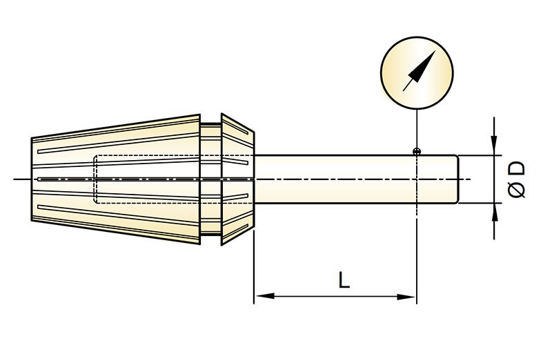

ER COLLETS RUNOUT TOLERANCE
DIN ISO 15488 specifies the dimensions, materials and manufacturing requirements, and designation of collets (of form A or of form B) for tools with cylindrical shanks and their corresponding holders and nuts. All Haas ER collets are manufactured to meet or exceed these requirements.
    Form A: 6 to 8 slots.
    Form B: 12 to 16 slots.
This International Standard also specifies collet runout tolerances. These tolerances are checked as is shown in the figure below, by the introduction of a test mandrel into the collet. The diameter of the test mandrel is the nominal diameter of the collet.
For the test mandrel, the following specifications apply:
    a) diameter tolerance: h6;
    b) cylindricity: 0.002mm;
    c) parallelism: 0.002mm;
    d) roundness: 0.002mm;
    e) surface without longitudinal marks;
    f) maximum surface roughness Rz = 4µm;
    g) surface hardness: (58 +3/-0) HRC.

 a     Normal style collets are designed with runout tolerance class 2. If class 1 is required, it shall be given separately.
 b     In the case of applications where runout tolerances class 1 are required, the accuracy of the whole system (machine tool spindle, holder, collet, and tool) shall be observed.
