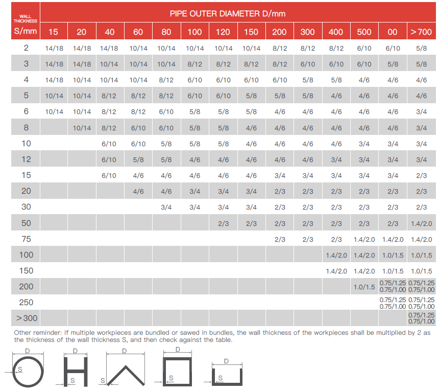

The proper Teeth Per Inch (TPI) of a saw blade is determined by the thickness of material being cut. Selecting the correct TPI will maximizes the efficiency and tool life of a saw blade.
For Solid Bar material use the chart below as a guide:
For channel/tubing material use the chart below as a guide:
