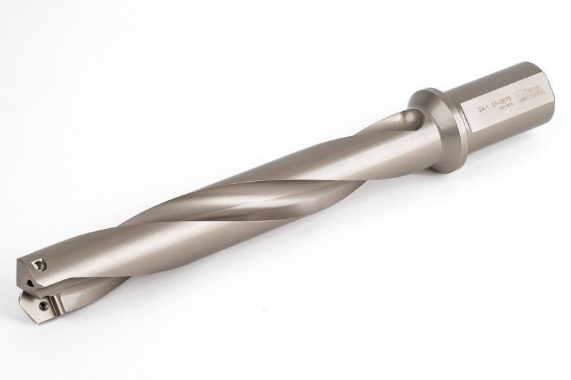

Spade drills feature a tool steel body with through-tool coolant and inserts that are secured to the tool body using screws. The straight shank diameter with a flat allows easy mounting in mill or lathe tool holders.
  Benefits:
  • High penetration rates and lower chip friction
  • Available in larger diameters than solid drills
  • Inserts can be changed without removing the tool from the holder
  • Use the same drill body for different materials and sizes by changing inserts
  • Drill bodies available in straight flute and spiral flute.
Straight Flute: recommended for horizontal drilling on lathes
Features:
  • High wear resistance and reduced material adhesion
  • High cutting speeds and feeds
  • Better hole quality over conventional spade drills
  • Stable torque
  • Self-centering
  • Long tool life
  • Smooth cutting
  • Breaks chips
  • Low thrust
  • AlCrN coating
Split Point Inserts for self centering.
Spiral Flute: recommended for vertical drilling on mills
Insert Chip Breaker, Grade and Coating
Chip breakers and Insert grades are combined based on your selected workpiece material.
  • ST chip breaker with CS carbide grade for all steels,
  • Cl chip breaker with C3 carbide grade specifically for cast iron
  • SS chip breaker primarily for stainless steel. Due to the 'general purpose' C2 carbide grade makes this insert also suitable for cast iron, nonferrous and high temp alloys
