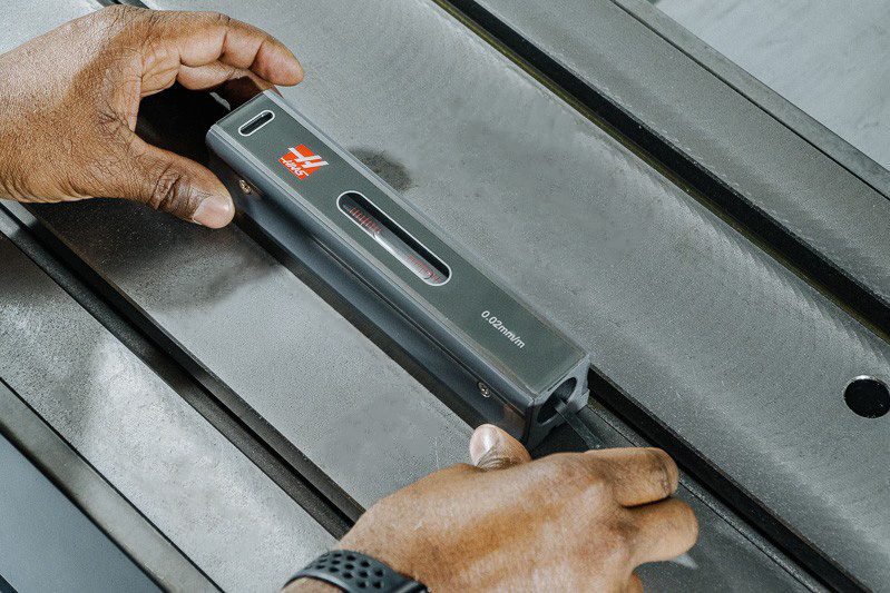

A machinist's level is used to help level machines and large workpieces. The cast iron body ensures good thermal stability for consistent readings. The cross-test vial allows the machinist to simultaneous level in both directions, preventing inaccuracies in reading. The level can also be used to measure machine level as well as pitch and roll of machine tool axes.
Features
  • Can be used to measure machine level as well as pitch and roll of machine tool axes.
  • Two indicator vials allow for simultaneous readings in both directions
  • Cast iron body ensures good thermal stability for consistent readings
  • Precision ground bottom surface
  • Made in accordance with DIN877
  • V-groove base

Haas Tooling Precision Machinists Level
Orville introduces us to the Precision Machinists Levels that are available now on HaasTooling.com. These levels are available in both inch and metric graduations and are accurate to 0.0002" over 10 inches and 0.02mm over 1 meter respectively. These accurate tools provide a means for checking and adjusting the level of your mill or turning center so that you can maintain machine accuracy.
