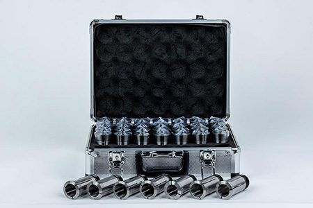

5C collets, also known as 385E collets, are a popular alternative to standard 3-jaw chucks for holding cylindrical workpieces up to 1-1/8” or 28mm, and bar stock up to 1” or 25mm in diameter. Collets are easy to change out, allowing faster set-up times, and they provide 360-degree support for the workpiece for higher accuracy. These collets provide a much stronger grip and superior concentricity than a standard 3-jaw chuck.
Collet Selection Guidelines:
  • Collets are available individually or in kits
  • Collet series is determined by the internal surface and shape (smooth or serrated round, square, hexagonal, etc.)
  • Collet bore diameter is determined by the workpiece diameter
Round 5C Collets:
  • Can be used to hold any type of round or odd-shaped material
  • Strong grip of material for a variety of machining applications
  • Provide 360-degree support for the workpiece
  • High accuracy and concentricity
  • Repeatable and easy to use
5C Round Collet Clamping Range (Inch):
  • 1/16" to 1-1/8" in 1/64" increments
5C Round Collet Clamping Range (Metric):
  • 3mm to 28mm in 0.5mm increments
