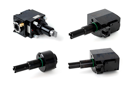

Haas live tooling options boost productivity by allowing secondary operations – such as milling, drilling, flatting, and tapping – to be performed in a single setup, on one machine. Two types of driven (live) toolholders are used on Haas machines, depending on the machine series* and turret type: BMT45/65/75 or VDI40. Both axial and radial toolholders are available.
BMT45/65/75
  • Industry-standard base-mount bolt pattern
  • Black oxide coating for corrosion resistance
  • Coolant delivery hardware included
  • Includes manufacturer’s warranty
VDI
  • Fits Haas VDI and VB (hybrid) turrets
  • Industry-standard 40 mm VDI mount
