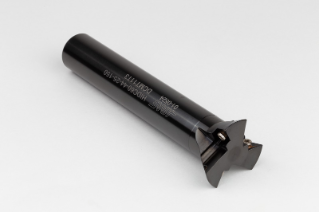

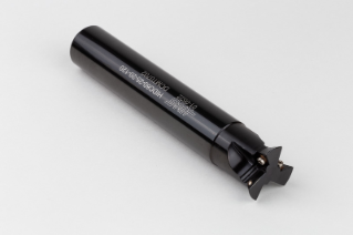

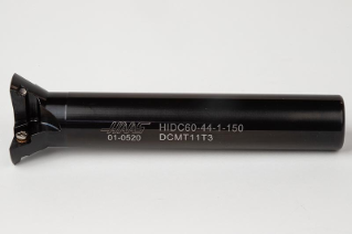

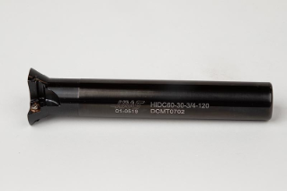

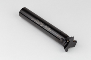

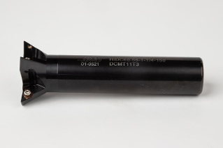

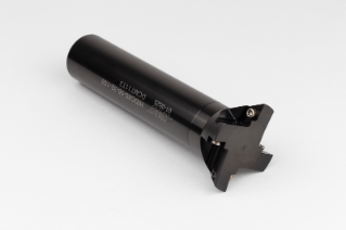

Haas indexable dovetail cutters are available in several shank sizes, with a variety of cutting diameters. These premium indexable dovetail cutters have precision shanks, and accept standard D-style (55° rhombic) turning inserts, which are available in Haas grades suitable for machining most materials.
All cutter bodies have a 60° included angle, and are suitable for cutting dovetails and chamfers, as well as light face milling operations. Cutters are 3-flute or 4-flute, depending on size, and the insert inscribed circle (IC) is determined by the specific cutter body.
