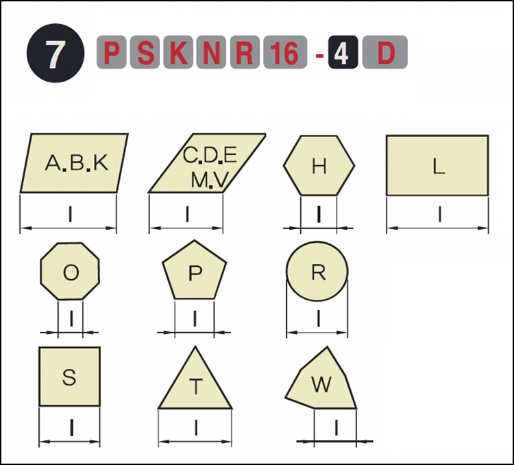

Insert Styles
____________________________
C-Style Inserts – 80° Rhombic
For external machining and facing. The large point angle is very rigid, and good for rough machining. This is the most commonly used insert.
D-Style Inserts – 55° Rhombic
The smaller point angle of this insert is more versatile for finishing and detail work, but it has less cutting-edge strength than other geometries.
V-Style Inserts – 35° Rhombic
T-Style Inserts – 60° Triangle
For internal machining. The 60° cutting angle provides medium cutting-edge strength that allows for both ID roughing and finishing applications.
W-Style Inserts – 80° Trigon
This insert has 3 cutting edges per side. The 80° cutting angle provides high cutting-edge strength for roughing, but the depth of cut is limited by the short cutting edge.

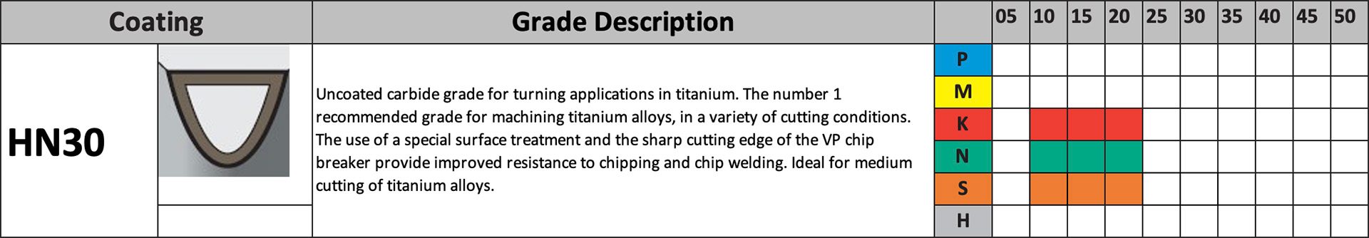

Insert Grades
DECODING HAAS GRADES: HTP15
BRAND
H
Haas
APPLICATION
T
Turning
PRIMARY WORKPIECE MATERIAL
P
  P – Steel
  M – Stainless Steel
  K – Cast Iron
  N – Non-Ferrous
  S – High-Temp Alloys
  H – Hardened Materials
  U – Universal Machining
APPLICATION RANGE
15
10 – Uninterrupted
15 – Light Interrupted
20 – Medium Interrupted
25 – Medium Interrupted
35 – Heavy Interrupted
WEAR RESISTANCE
10
15
20
TOUGHNESS
25
30
35
SMOOTH
SURFACE
MEDIUM TO
ROUGH SURFACE
ROUGH
SURFACE
Smooth Cut
Pre-Turned
Lightly
Interrupted
Heavily
Interrupted
CLICK + TO EXPAND
CCET Insert Grades

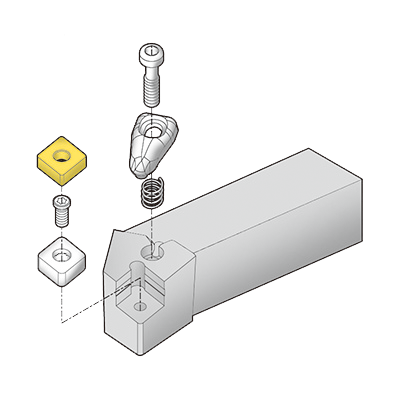

CLAMPING STYLES
Clamping Styles
M – Multi-Lock System*
• For negative-style inserts
P – Lever-Lock System
S – Screw-On System
• For positive-style inserts
D – Double-Clamp System
• Powerful single-lever screw clamping
• Spring design releases clamp automatically
• Optimized for chip flow
• Eccentric lock pin secures the insert against the side
• Top clamp provides rigid downward clamping
S – Screw-On System
* For multi-lock holders: Rotate the eccentric lock pin counterclockwise until the insert drops on, and then rotate the eccentric pin clockwise to secure the insert against the side of the holder. Install the top clamp to hold down the insert.
