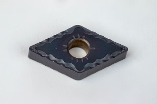

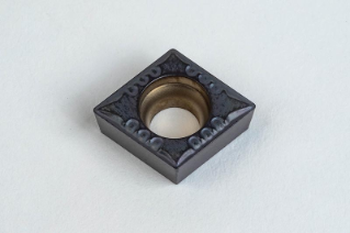

C-Style Inserts – 80° Rhombic
For external machining and facing. The large point angle is very rigid, and good for rough machining. This is the most commonly used insert.

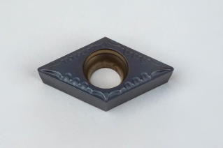

D-Style Inserts – 55° Rhombic
The smaller point angle of this insert is more versatile for finishing and detail work, but it has less cutting-edge strength than other geometries.

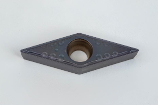

V-Style Inserts – 35° Rhombic
T-Style Inserts – 60° Triangle
For internal machining. The 60° cutting angle provides medium cutting-edge strength that allows for both ID roughing and finishing applications.
W-Style Inserts – 80° Trigon
This insert has 3 cutting edges per side. The 80° cutting angle provides high cutting-edge strength for roughing, but the depth of cut is limited by the short cutting edge.
