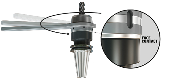

Assembly
  1. Clean the inside of the milling chuck, collet, and tool.
  2. Insert the appropriate size collet and tool into the milling chuck.
  3. Tighten using the spanner wrench until the cap contacts the body of the chuck. Full-face contact must occur between the cap and the chuck body.
CAUTION
  • Never tighten the milling chuck cap without a tool inside of it — permanent damage will occur.
  • Only install smooth shank tooling into the milling chuck. Weldon flats and other side-lock style tooling will not be held with as much force and can cause the bore of the milling chuck to permanently deform.
Tool Removal
  1. Loosen the cap with the spanner wrench until the tool can be removed.
  2. Remove the tool.
  3. Loosen the cap until it’s out and continue to loosen it an additional 1 to 2 turns. This will re-align the bearings and ensure full and accurate clamping the next time the milling chuck is used.
