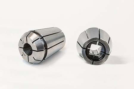

ER Sealed Collets – Features
NOTE: Collet bore is the exact diameter of the tool shank. These collets have no clamping range.
  • Fits all Haas ER collet chuck holders
  • Ensures 100% of through-tool/spindle coolant gets to the tip of the cutting tool
  • Approved for high-pressure coolant to 1100 psi
  • Short rear collet slots provide a mechanical seal, blocking coolant flow
  • Mechanical seal design is superior to silicone/rubber sealed collets
  • Do not require a coolant ring or special ER nut
  • To seal properly, the entire tool shank must be in the collet and cover all slots
ER Tap Collets – Features
  • Collet bore is the exact tool diameter, with a square drive
  • Special design locks flat-sided tap shanks into the collet
  • Provides maximum concentricity, with positive driving force
  • Reduces tapping clearance requirements
