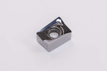

HPAL – Haas High Positive for Aluminum
Toolpath Type: Face Milling, Shoulder Milling, Slotting, Ramping, Helical Milling, Copy Milling
90° cutting edge | D.O.C. max. 0.67" (17.0mm)
• Designed for high-speed machining of aluminum
• Buffed surface for smooth chip evacuation and reduced BUE
• High rake angle for good surface finish and lower cutting loads
• For square shoulder milling and curved surface machining

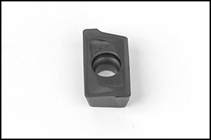

HIEX/HPSM – Haas High Positive Shell Mill
90° cutting edge | D.O.C. max. 0.649" (16.5mm)
• Superior perpendicularity and minimized cutting loads
• Optimized for high-quality surface finishes
• High rake angle lowers cutting loads and minimizes burrs
• High-speed and high-feed capability improve productivity

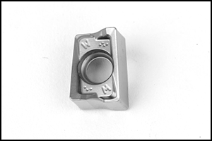

HIE – Haas Indexable End Mill
Toolpath Type: Face Milling, Shoulder Milling, Slotting, Ramping, Helical Milling, Axial Plunge Milling
90° cutting edge | D.O.C. max. 0.217" (5.5mm)
• 3-face clamping for stable operation in tough conditions
• Suitable for plunge milling

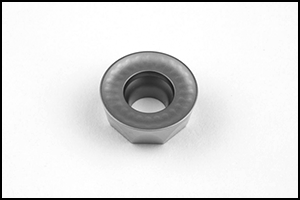

HRPP – Haas Round Positive Positive
Round edge | D.O.C. max. 0.236" (6.0mm)

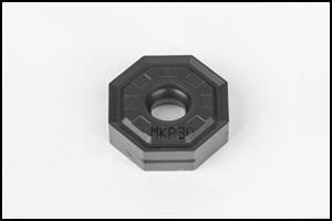

HONP – Haas Octagon Negative Positive
45° cutting edge | D.O.C. max. 0.217" (5.5mm)
• Negative axial rake, positive radial rake
• Double-sided inserts with 16 cutting edges
• Special geometry for consistent cutting and long life
• Strong insert and powerful clamping

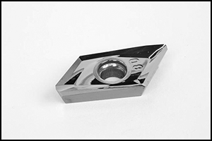

HVPP – Haas 35° Rhombic (V) Positive Positive
Toolpath Type: Axial Plunge Milling, Ramping, Shoulder Milling
90° cutting edge | D.O.C. max. 0.394" (10.0mm)
• Positive axial rake, positive radial rake
• 35-degree rhombic inserts with two different nose radius options
• High polish for excellent surface finish and reduced built-up edges
• Large chipbreaker grooves for controlled chip evacuation
• Low cutting forces due to the positive cutting edge
