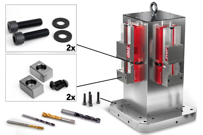

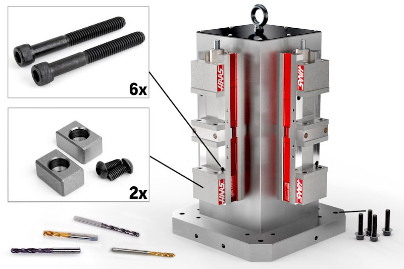

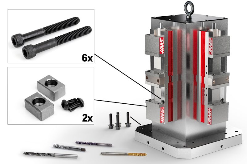

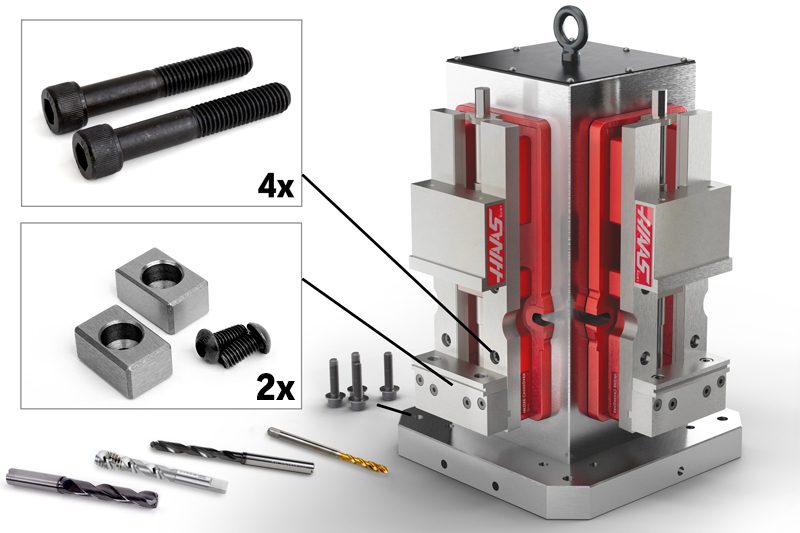

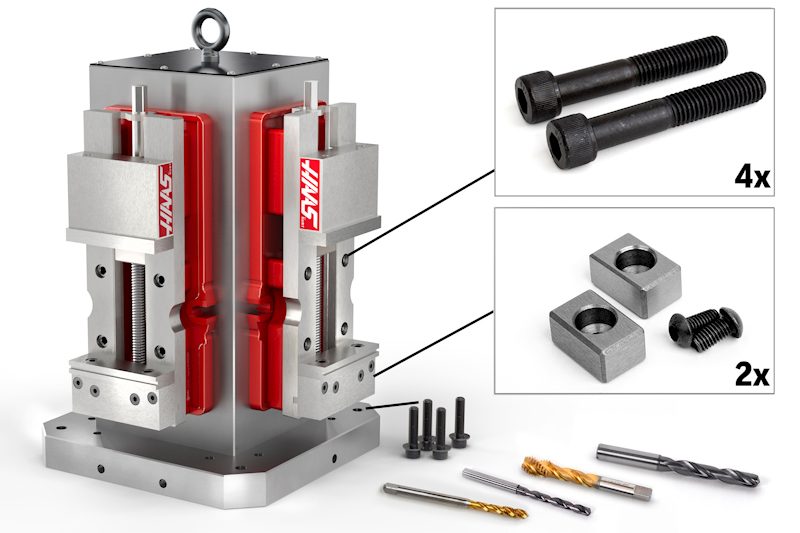

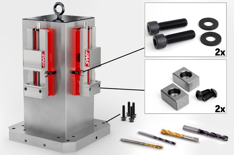

Tombstones offer maximum part production and increase throughput on your horizontal machine. Haas makes purchasing tombstones even easier with a complete lineup of tombstone kits. Kits offer all you need for mounting the tombstone to the machine plus including the drills and taps to easily prep your tombstone for mounting of vises.

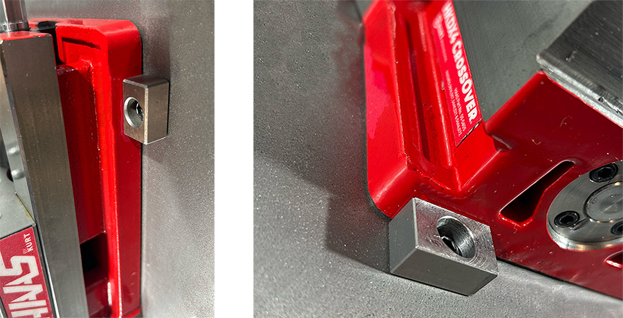

All Haas Tombstone Kits include vise-body locating key stops, which aid in supporting the vise for easy installation.
Kits Include:
  • Cast Iron or Aluminum Tombstone
  • 2 Vises
  • Drills and Taps for Vise Mounting
  • Tombstone and Vise Mounting Hardware

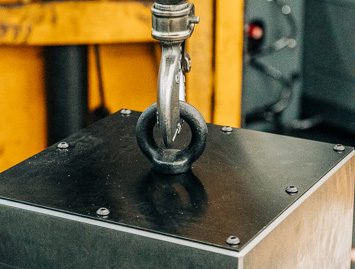

Everything For Mounting | Everything For Lifting
All Included
Haas Tombstones offers all of the hardware needed to lift and mount your tombstone. Including metric and inch mounting hardware for both styles of pallets.

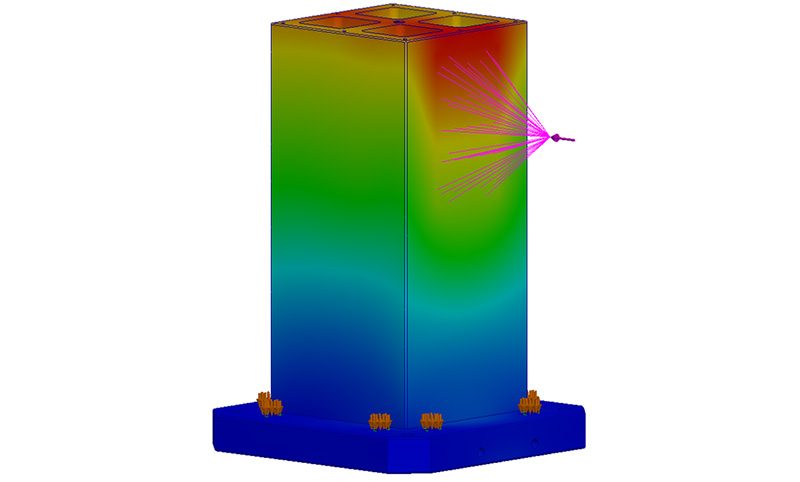

Lighter weight | Same rigidity
SAME RIGIDITY, HALF THE WEIGHT OF OTHER TOMBSTONES
FEA Optimized For Maximum Rigidity & Less Weight
How Did We Save The Weight & Maintain Rigidity?
  • Gussetting on Interior walls
  • Top & Bottom Face Pocketing
  • Cautious Wall Thinning
  • Base Size Reduction
