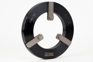

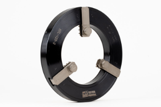

Scrolling Pin (HTL) Lathe Boring Ring
  • Provides higher accuracy, and allows finer control for shops needing to dial-in their jaw position
  • Prevents jaw lifting by providing uniform pressure on each jaw
  • HTL-100 fits a 6" (165 mm) chucks, but also covers 5" (135 mm) and 8" (210 mm) chucks
  • HTL-125 fits a 8" (210 mm) chuck, but also covers 6" (165 mm) and 10" (254 mm) chucks
  • HTL-160 fits a 10" (254 mm) chuck, but also covers 8" (210 mm) and 12" (305 mm) chuck
  • Pins are reversible for larger diameter jaw clamping
Shop All Scrolling Pin Lathe Boring Rings

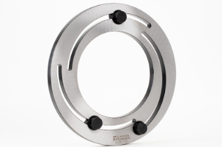

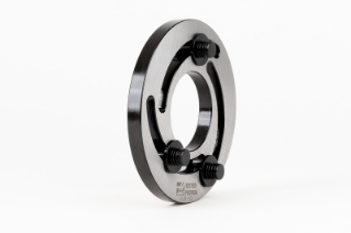

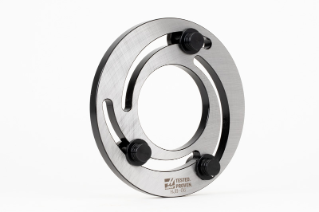

Sliding Pin (HJB) Lathe Boring Ring
  • Provides concentric and precise boring of your soft jaws
  • Available to fit 5" (135 mm) - 15" (381 mm) lathe jaw chucks
  • Sliding pins allow easy adjustment of the jaw clamp position
  • Prevents jaw lifting, by providing uniform pressure on each jaw
  • Each ring is specific to your lathe chuck size
  • Low cost in comparison to a scrolling pin boring ring
Shop All Sliding Pin Lathe Boring Rings
