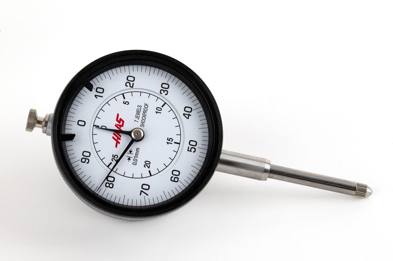

Haas Tooling offers a full lineup of drop indicators for improving setups and calibrations. Drop indicators allow operators to quickly measure runout, height, flatness, and distance in multiple applications. These indicators feature a dial or digital face fixed to a stem with a plunger-typer contact point.
  • Offered in inch (U.S. Only) and metric versions
  • Strictly made in accordance with DIN878
  • Jeweled bearings provide the lowest possible bearing friction providing higher sensitivity and quick response ability
  • Sleeved measuring rod reduces side-to-side play and maintains smooth movement
Dial Drop Indicators
  • Offered in inch (U.S. only) and metric versions
  • Bidirectional dial allows for easy readings in positive and negative directions
  • Available with jeweled bearings
  • Shockproof versions for resistance to impacts and vibration
  • Made to DIN878 standards
Inch Range (U.S. Only):  0.5 - 2”
Inch Graduatations: 0.001” or 0.0005"
Metric Range: 10 - 100 mm
Metric Graduation: 0.01 mm
Accuracy: ± 0.00075 - ± 0.002 in \ ± 0.017 - ± 0.05 mm
Digital Drop Indicators
  • Large, easy-to-read display
  • Instant switching between metric and inch measurements
  • Battery Type: CR2032
  • Includes certificate of calibration
Range:
0.5 - 2" \ 12 - 50 mm
Resolution: 0005 in \ 0.01 mm
Accuracy: ± 0.004 - ± 0.006 mm
