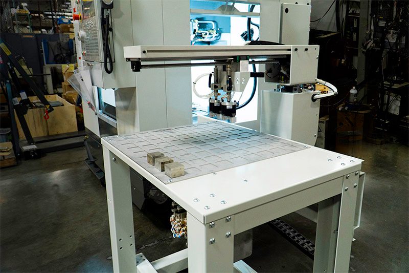

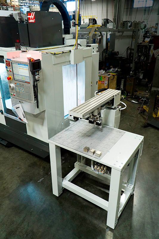

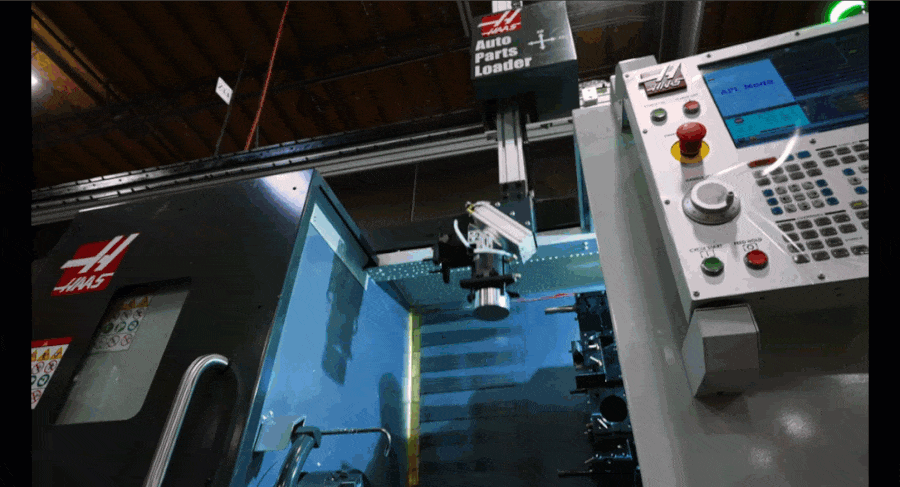

Compact APL Overview
The Compact Automatic Parts Loader (C-APL) is a simple way to automate part production on Haas VF-2 size vertical machining centers, including SS and YT models, the VM-2, DTs, and DMs. The easy-to-use interface in the Haas control guides you through a simple, step-by-step setup process that “teaches” the C-APL arm its positions, and has you fully automated in minutes, loading and unloading parts for unattended machining.

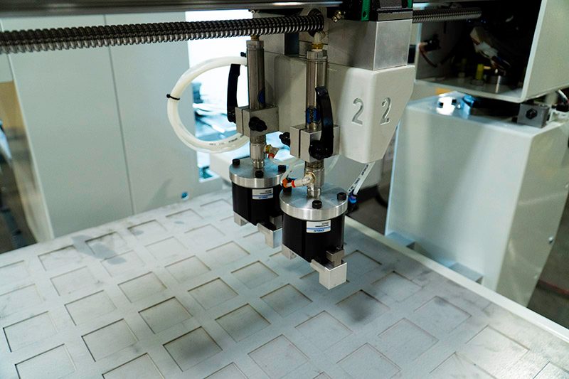

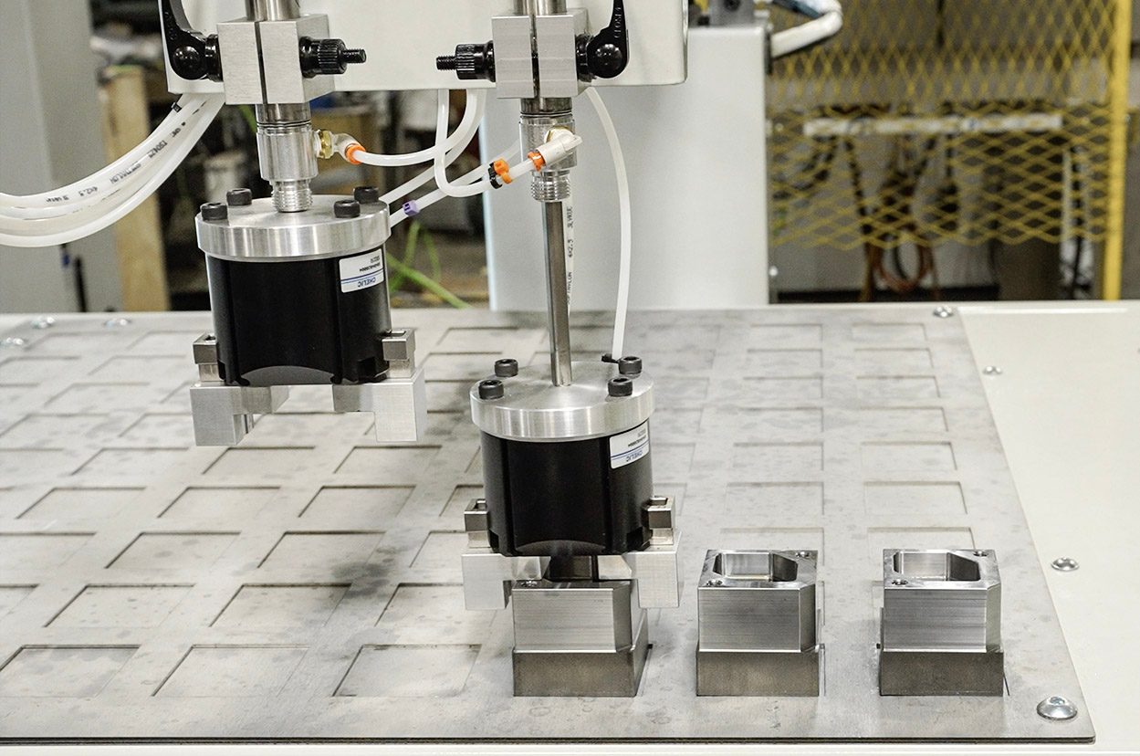

Compact APL Part Management
Part management on the C-APL table is done by creating a grid pattern template of equally spaced rows and columns. The C-APL grippers can accommodate up to 2" x 2" x 2" (51 x 51 x 51 mm), and weighing up to 3 lb (1.4 kg). Various part shapes can be loaded, and grippers can be adjusted or modified to best fit your parts.
The C-APL is programmed directly through the Haas control, and set up using the Haas APL interface, which guides the operator through the steps necessary to quickly program the C-APL. Answering simple questions, the operator enters basic information by either positioning the part grippers and pushing a single button to record the position, or by entering basic numeric values. All values are calculated automatically by the control, and the C-APL is ready to go.

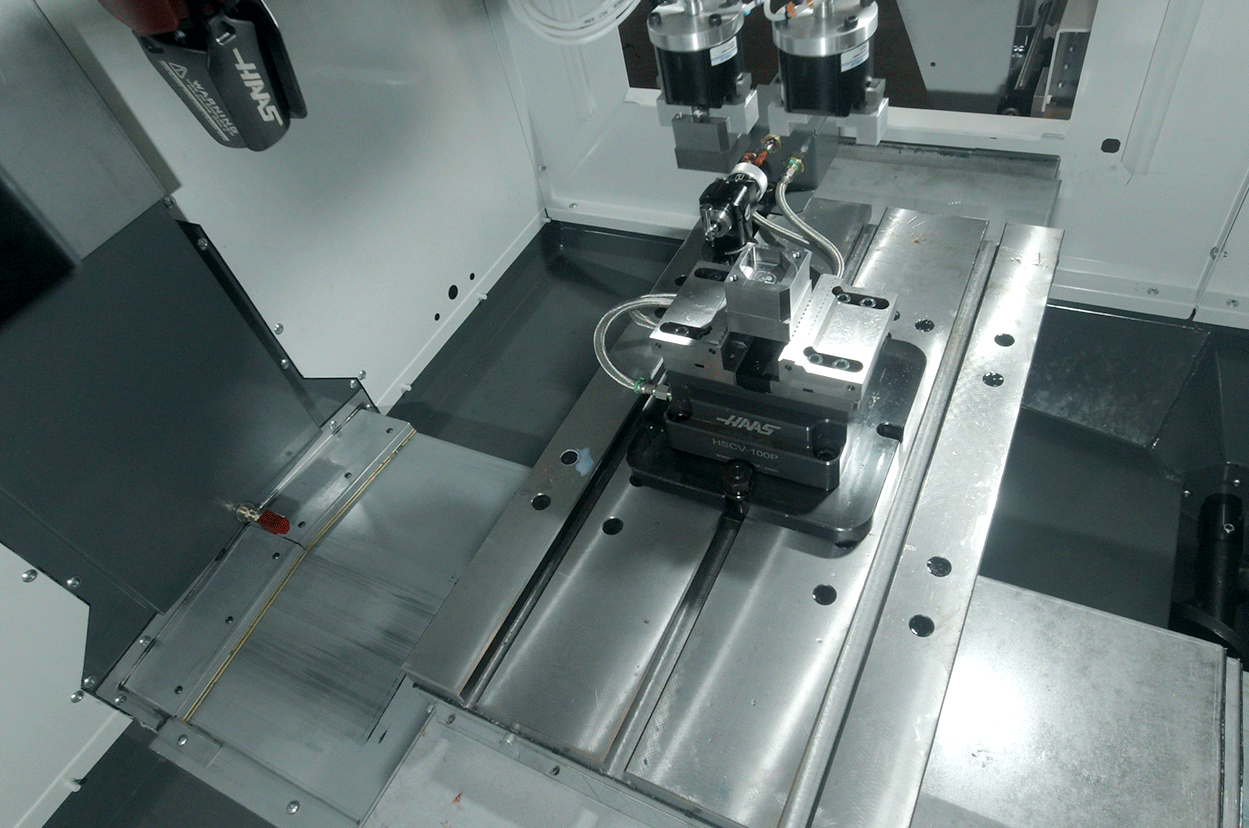

The C-APL operates in the background during normal machining operations, returning parts to the storage table and retrieving new raw pieces, while parts are being machined. The result is near-continuous, unattended machining. The double grippers save time by taking a machined part from the electronic vise inside the machine and replacing it with a new piece of raw material, without having to return to the storage table.
Compact APL Interface
Easy-to-Use C-APL Interface
Our easy-to-use C-APL interface uses simple, step-by-step instructions to help the operator “teach” the C-APL the correct positions for picking up, loading, and unloading parts.
  • The C-APL is operated directly at the machine’s pendent, allowing seamless integration
  • Step-by-step instructions and graphics help guide the operator through the setup process, for example:
    • Set part template pattern – number of rows and columns
    • Set first part pick-up position
    • Set staging position for C-APL to wait until machining is complete
    • Set load and unload positions at the electronic vise
    • Set part drop-off position for the first completed part
APL Mode
Simple to Operate in APL Mode
APL Mode seamlessly combines the part program selected in Memory [MEM] with a designated APL setup template to automate part production and boost productivity.
A new M-code was developed for use with Auto Part Loaders. M299 is typically used at the end of a part program. When the program is started by pressing [CYCLE START] in Memory mode, the M299 acts exactly like an M30 (Program End and Reset). But if the program is started while “APL Mode” is active, then the M299 will command the C-APL to load the first part from table, and then run the active program in Memory.
  • APL Mode
    • Simply replace your M30 with an M299 at the end of your part program
    • From the Run Job tab, press [INSERT] to select the designated APL setup template (Job) and turn on APL Mode; an “APL Mode” watermark will appear over your program, and you’re ready to go
    • Press Cycle Start, and the C-APL will load the first part, and execute the part program in Memory
    • While the part is being machined, the C-APL will drop off the completed part, and then pick up new raw stock and stage it at the designated load position
    • The operator can monitor table status, the number of parts completed, which number part is inside the machine, and which part is next
    • The cycle continues until all parts on the table are completed, or a specified number of parts is reached
