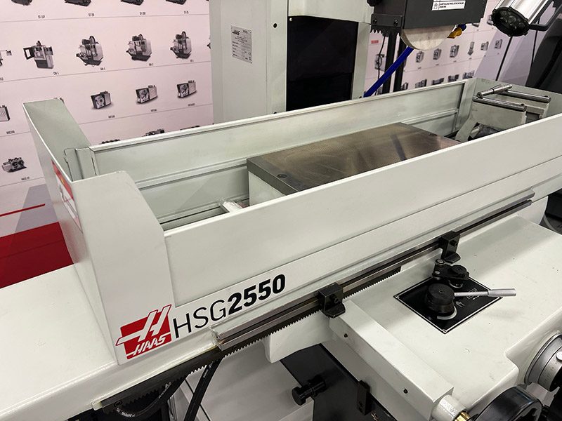

Haas Automatic Surface Grinder with 10" x 20" electromagnetic chuck
  • High-speed 3450-rpm spindle
  • Automatic X-, Y-, and Z-axis feed
  • Rapid Z-axis feed for quick height set up
  • Automatic rough, finish, and spark-out cycles
  • Automatic central lube system
The Haas HSG-2550 fully automatic surface grinder provides precision ground surfaces to critical sizes and finishes. Includes an 8" (200 mm) diameter grinding wheel and a 10" x 20" (250 x 500 mm) electromagnetic chuck.

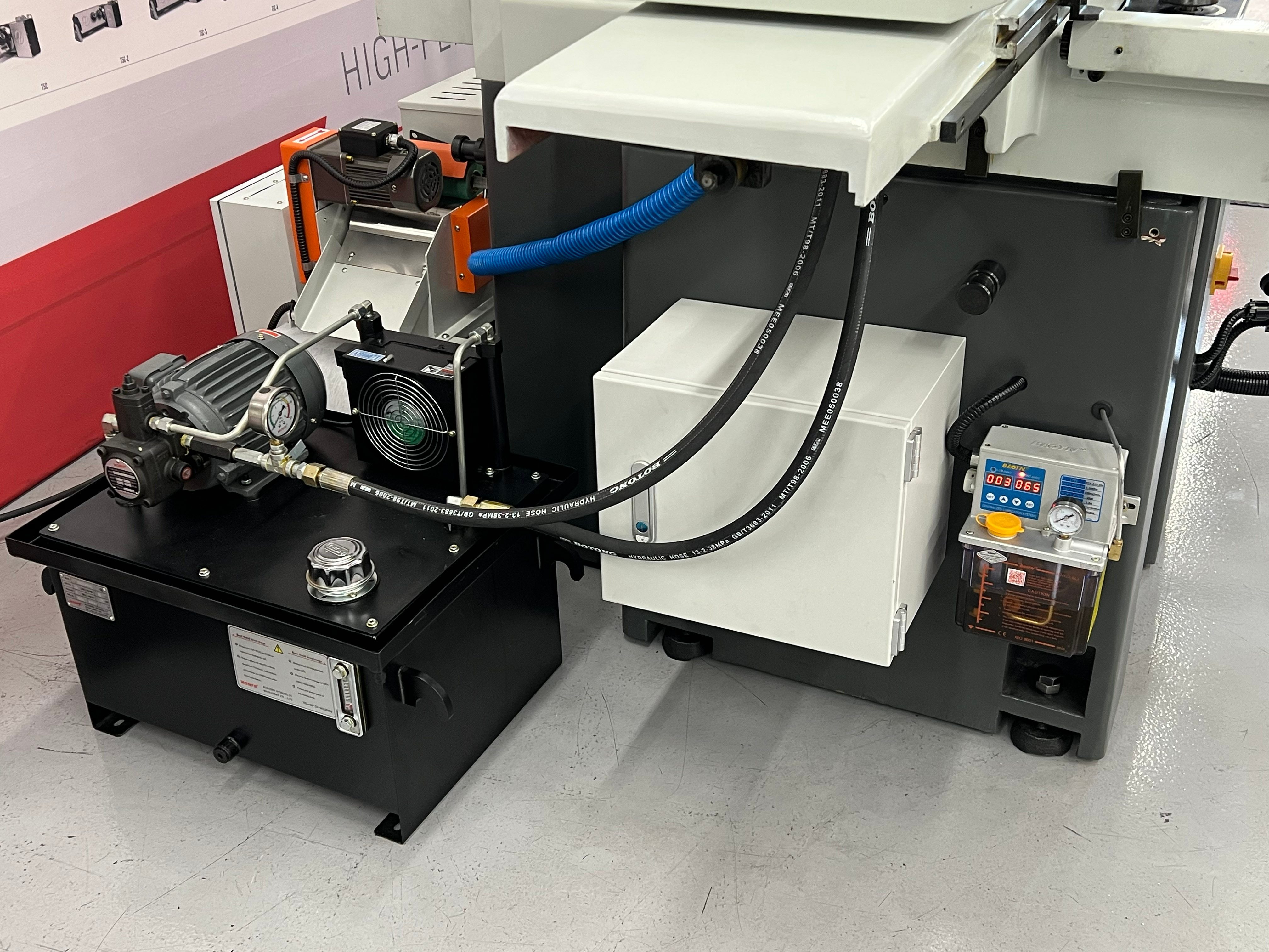

NOTE: Requires 15 gallons (57 L) of ISO32 hydraulic oil (not included).

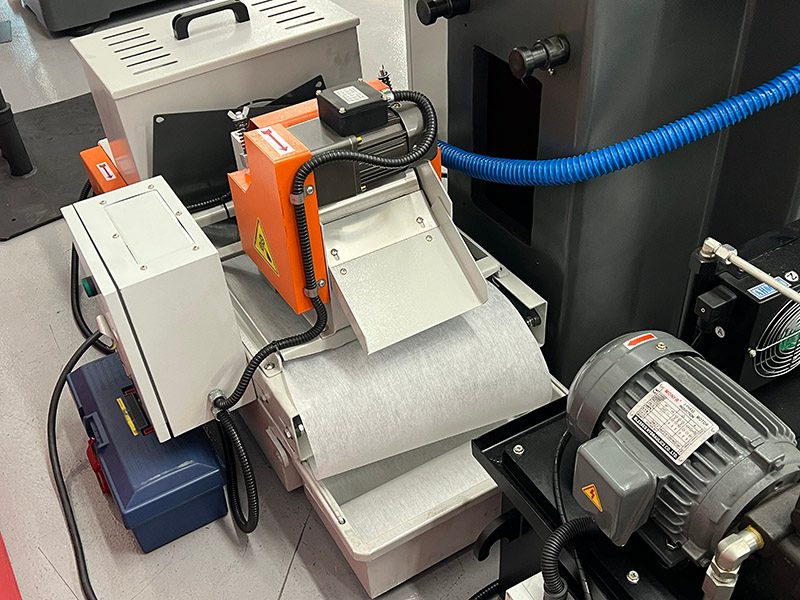

    Coolant Tank with Paper Filter

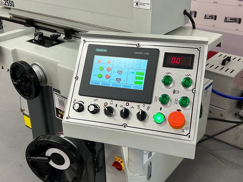

    Siemens Touchscreen

    Hydraulic Unit

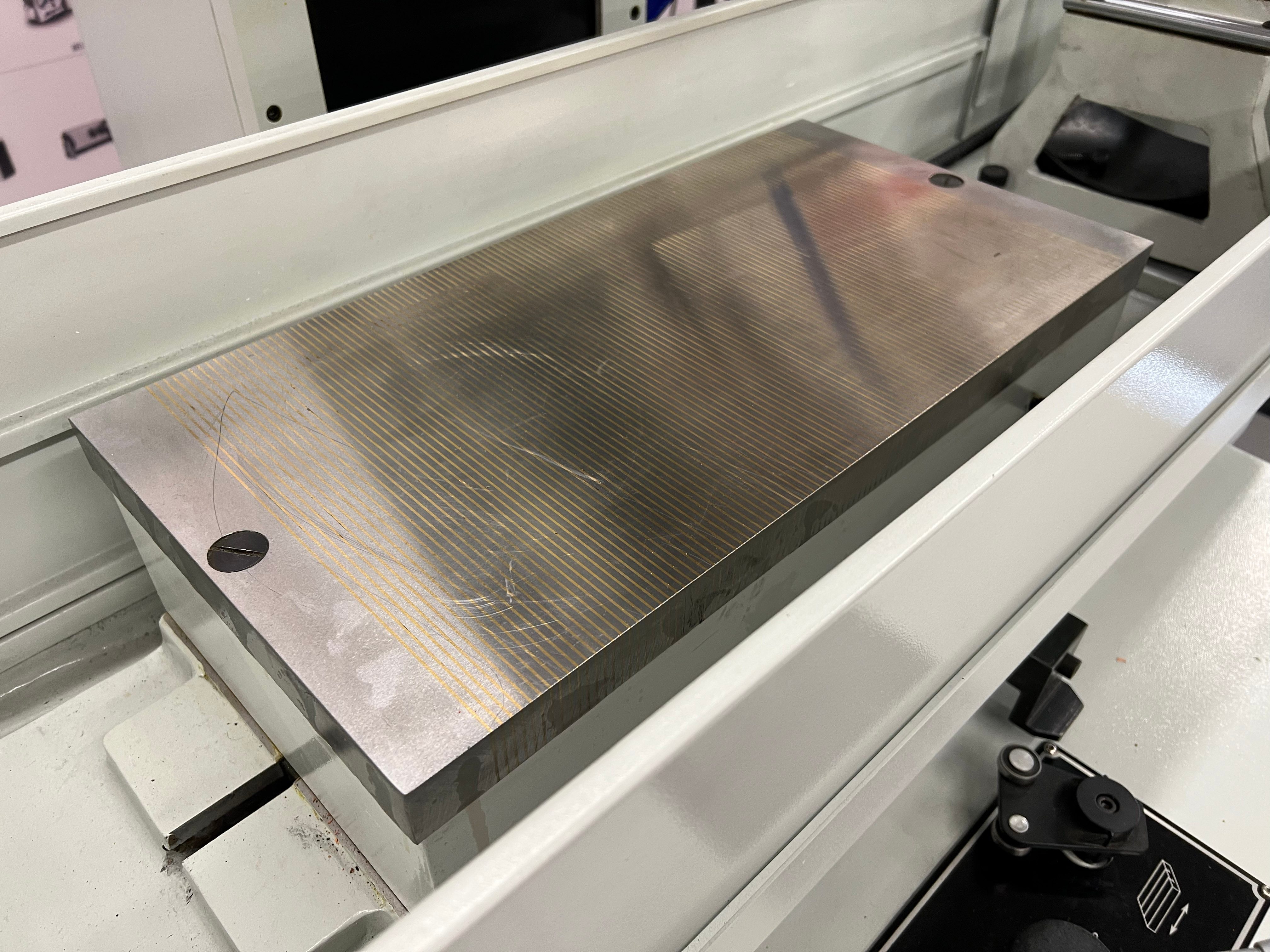

    Fine Pole Electromagnetic Chuck

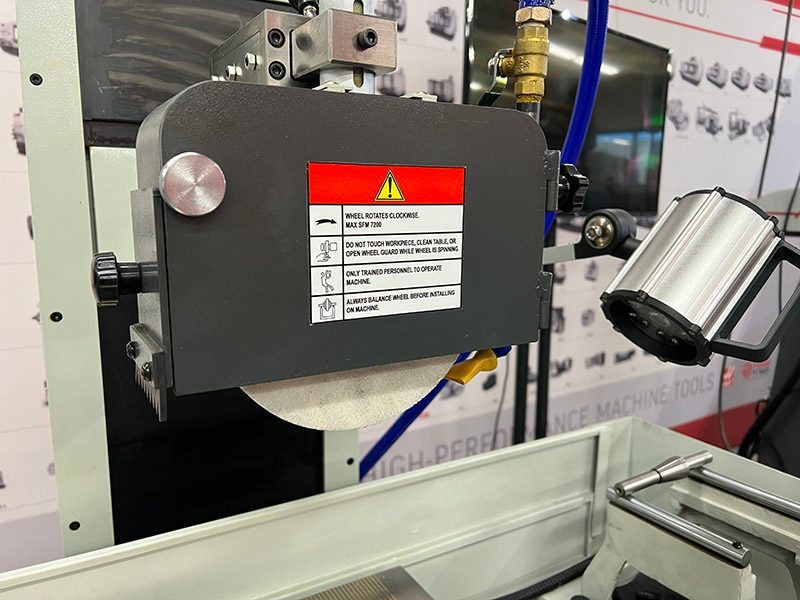

    Grind Wheel
    Filter Paper Roll

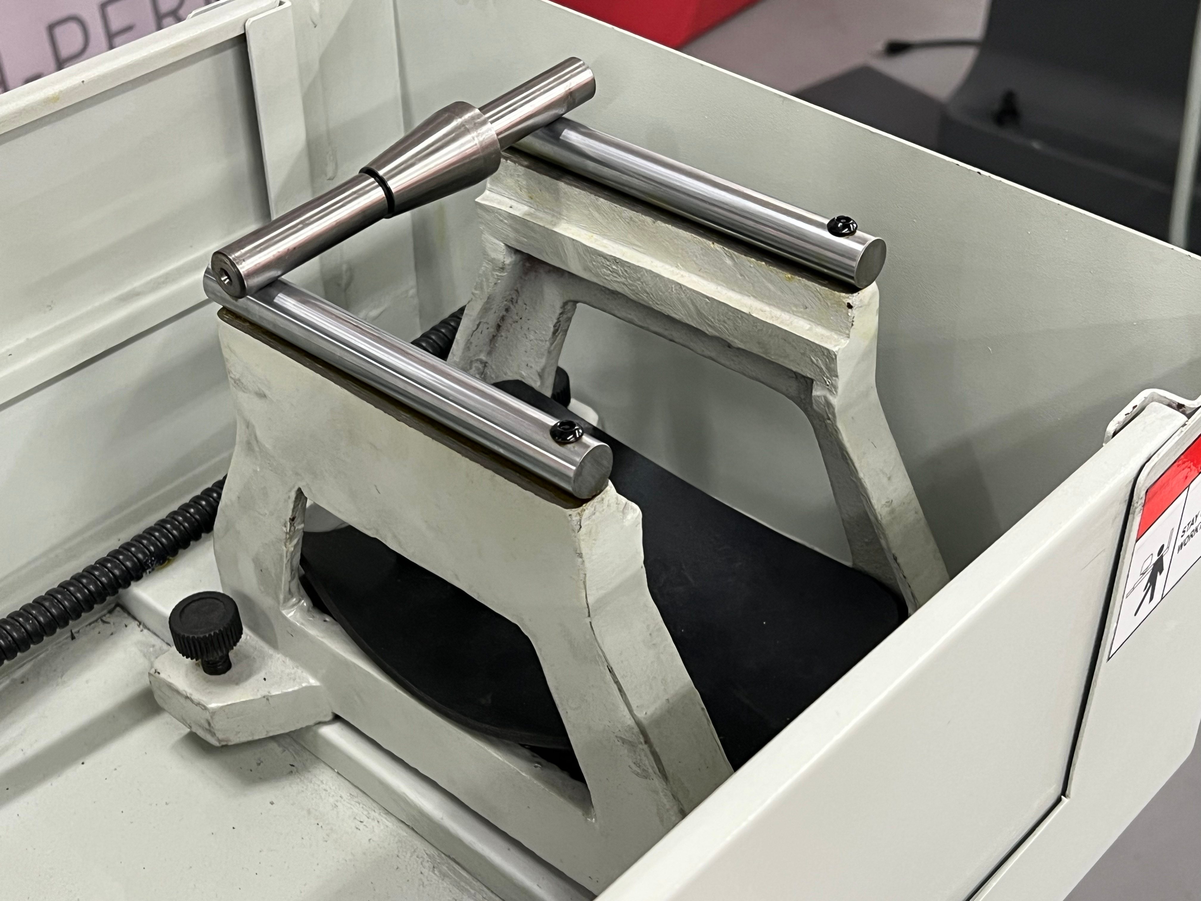

    Wheel Flange
    Wheel Balancing Stand
    Wheel Balancing Arbor
    Wheel Extractor

    Leveling the Balancing Base
    Balancing the Wheel
