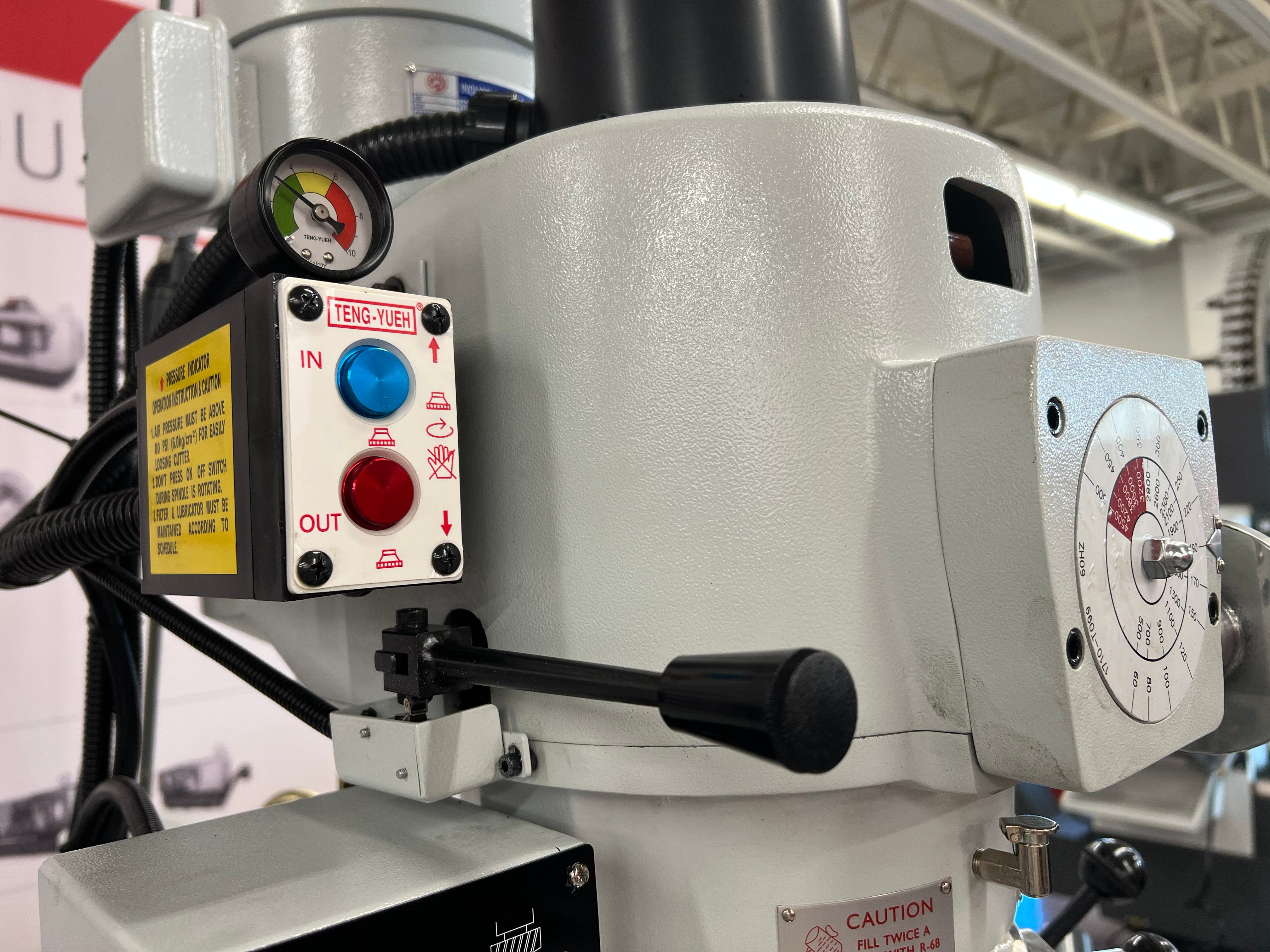

  • Pneumatic power drawbar

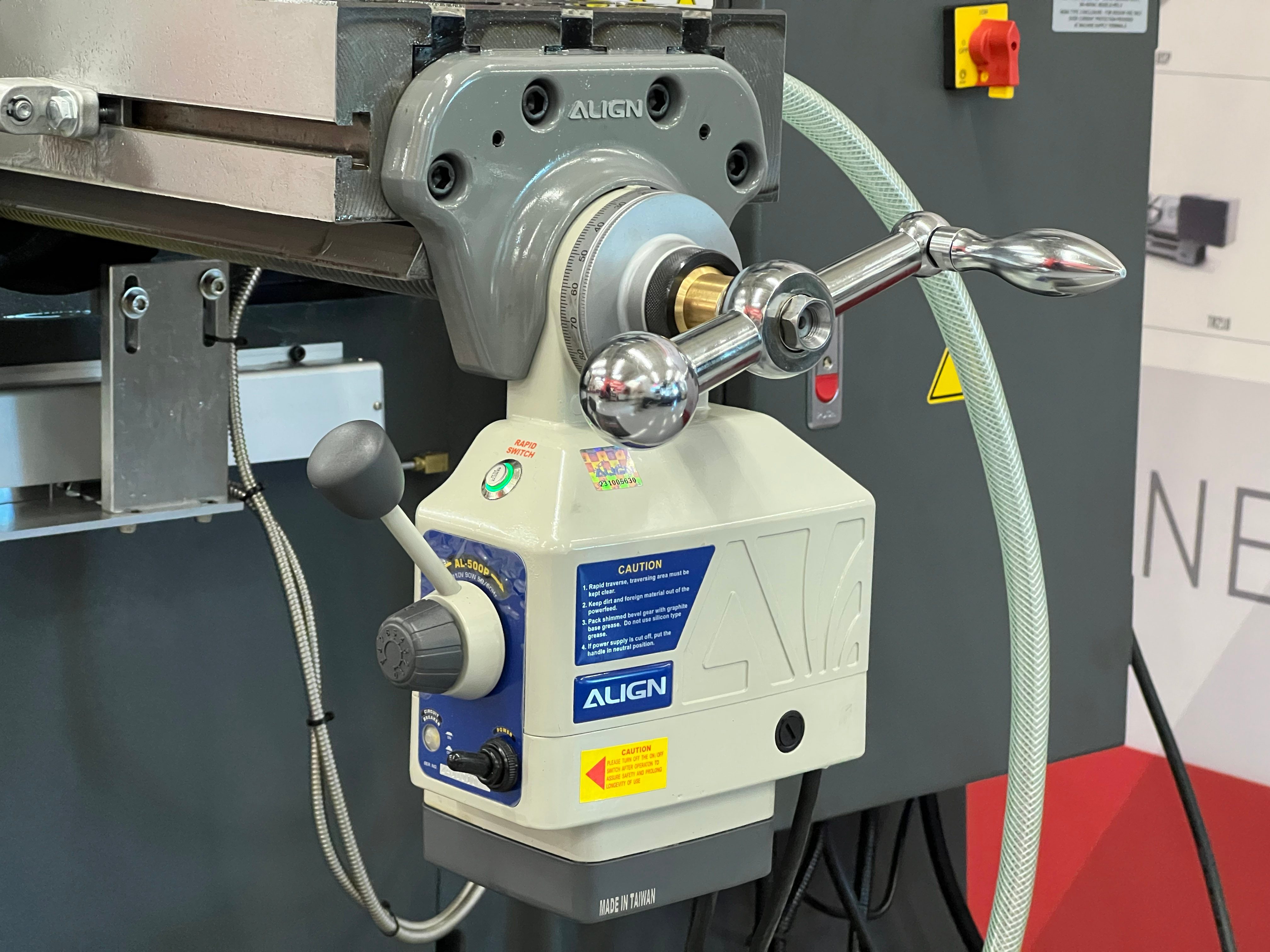

  • X-axis power feed w/clutch handles

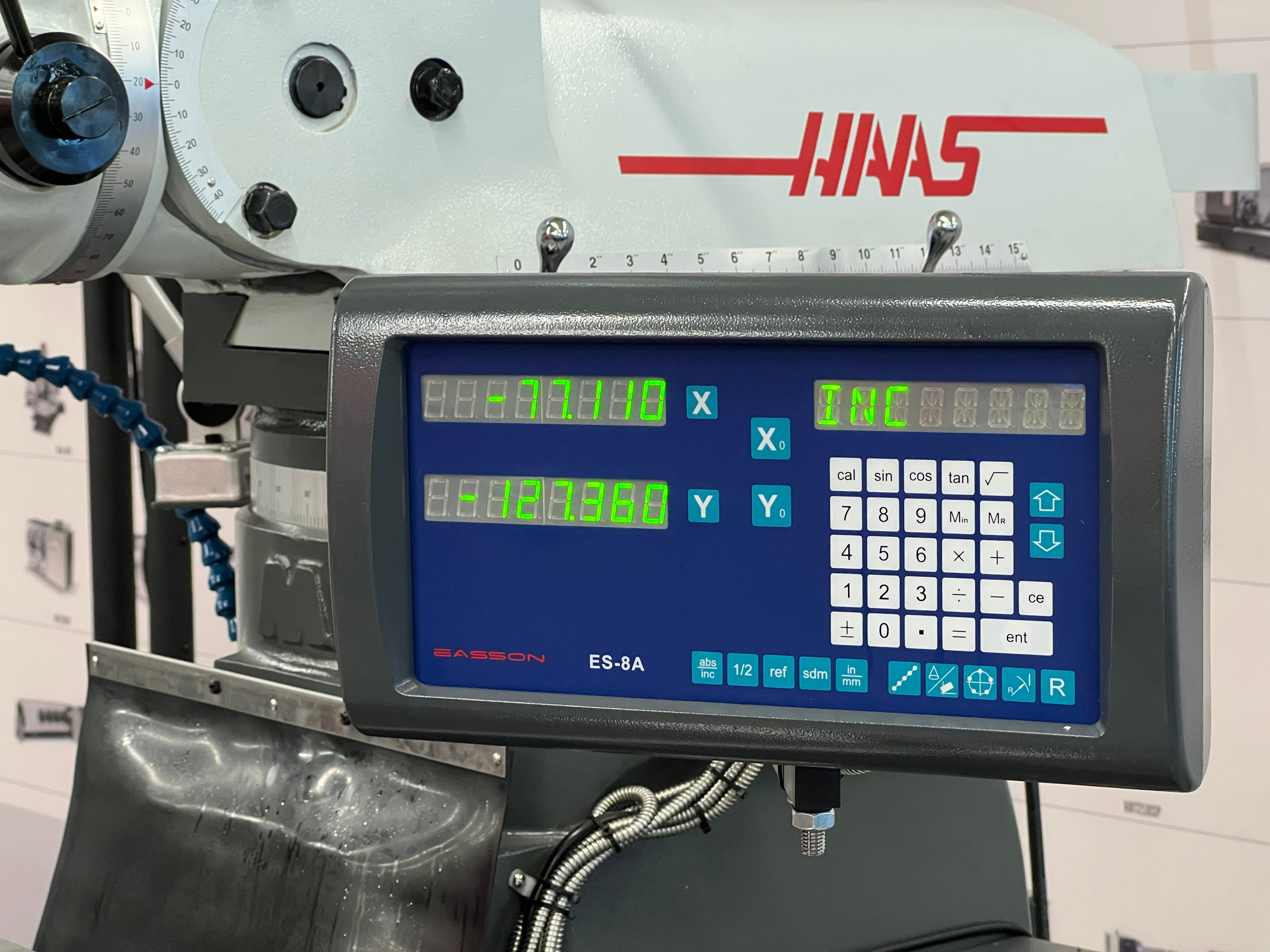

  • XY DRO

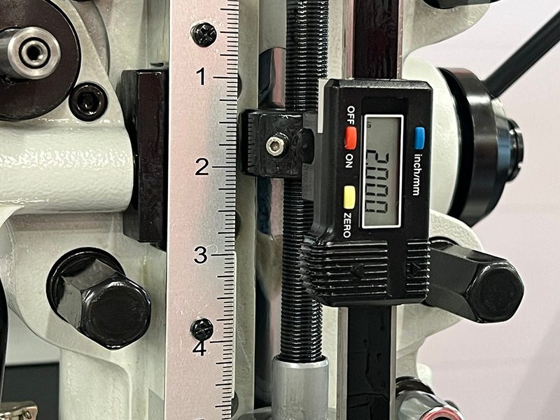

  • Digital quill scale

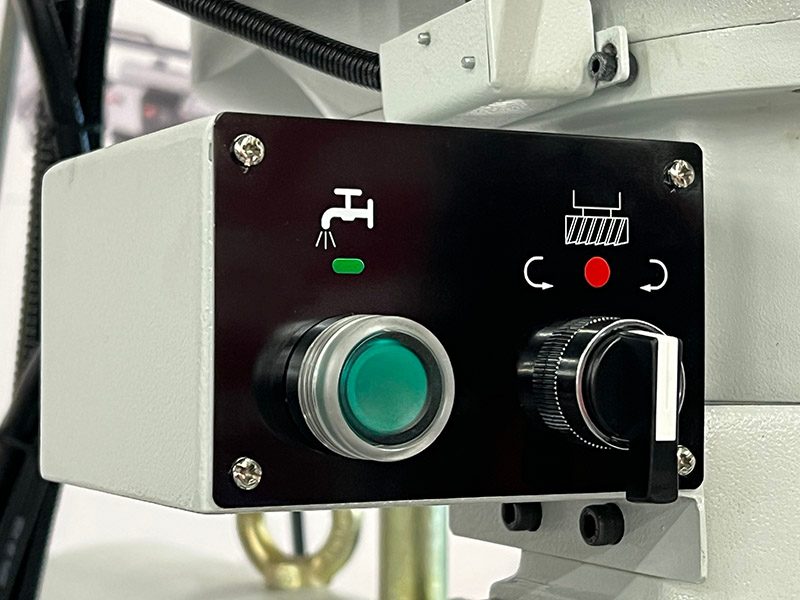

  • Coolant system w/chip tray

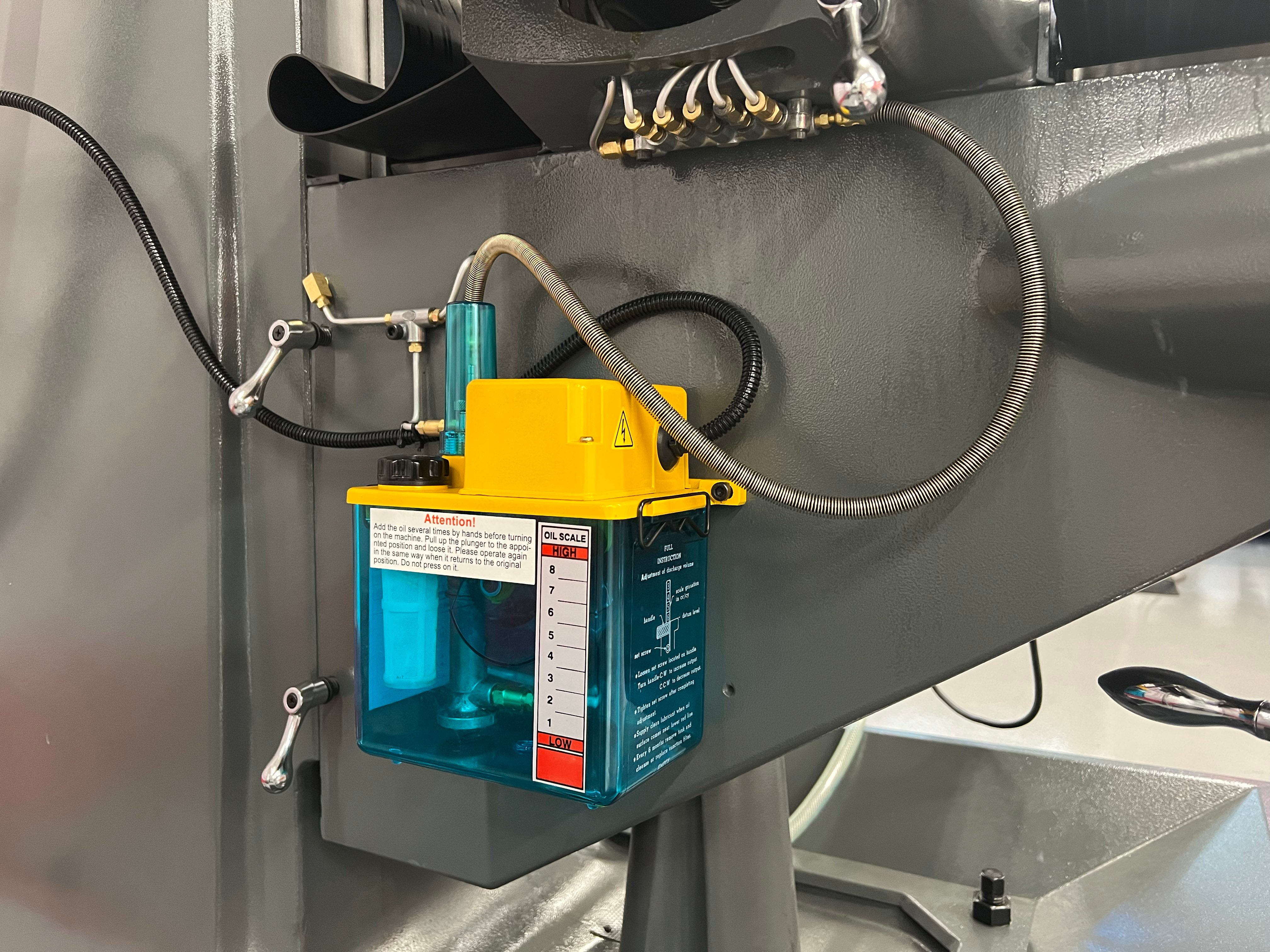

  • Automatic lubrication system

Coolant System with chip tray

Digital Readout on X and Y Axis
Digital Quill Scale

X-Axis Power Feed w/Clutch Handles
Automatic Lubrication System
Pneumatic Power Drawbar

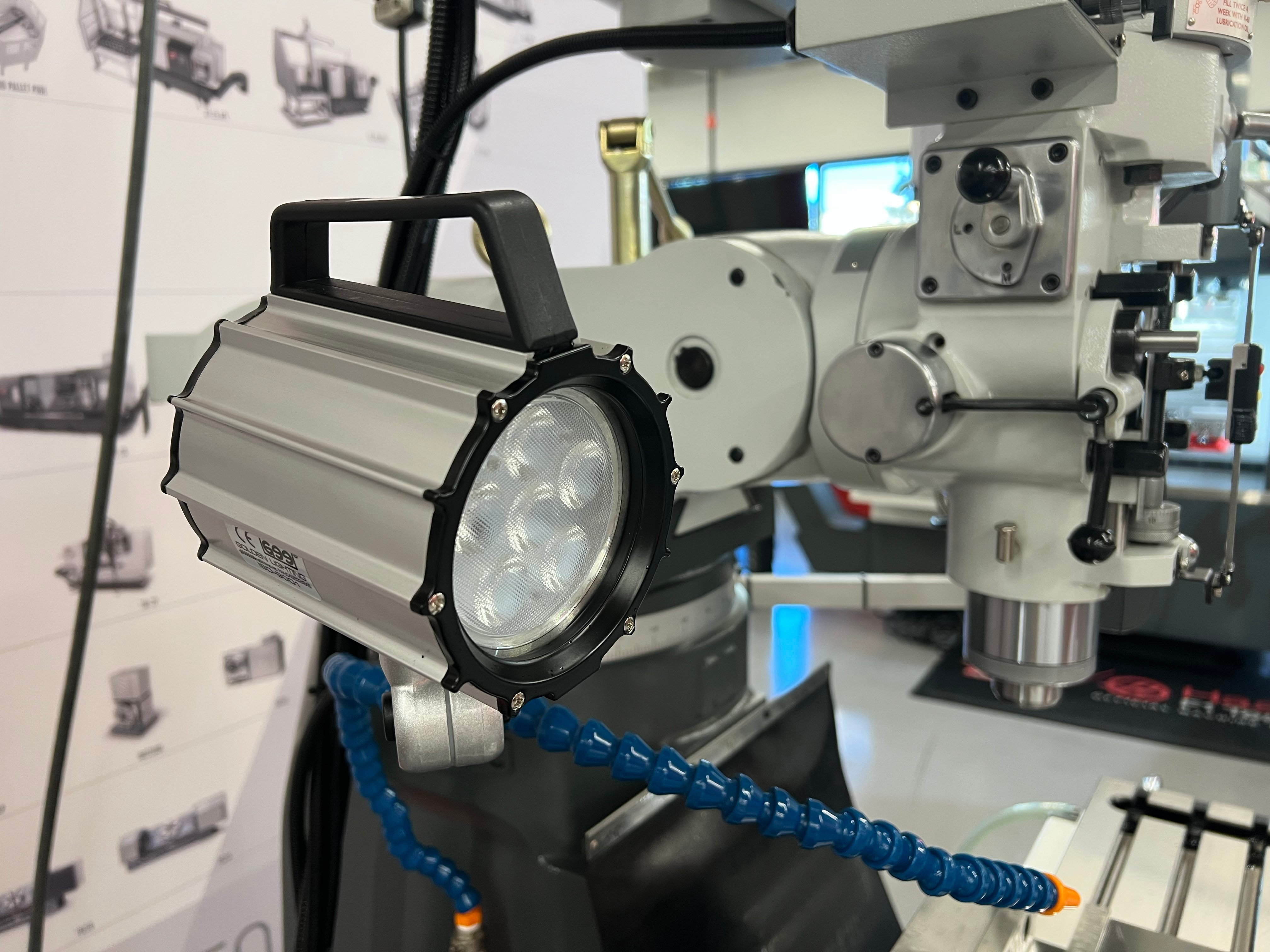

LED Work Light

Quill Travel 5" 127 mm
Quill Feed 0.0016" / 0.003" / 0.006" per rev 0.04 / 0.08 / 0.15 mm per rev
